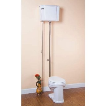

  10. kellory
    There are a few meanings. Yes, a simple toilet, sometimes refers to a whole bathroom, or to the old time version here..[​IMG]

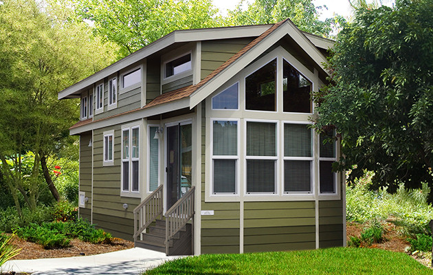

  19. Ganado
    Tully Mars, perfect small home with storage too! lol
    Park Model Lofts | Cavco Park Models
    Gator those are really great designs for the swamp areas. Cook on one side live on the other have breeze way in between nice pic =)
