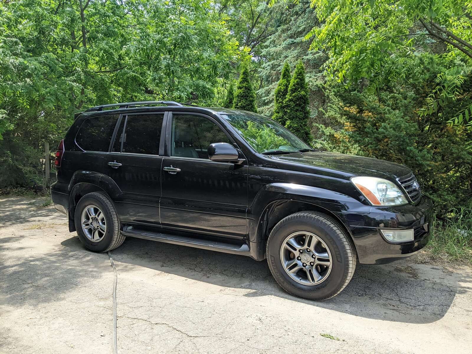

    Well, looks like I'm joining the Land Cruiser Clan on Saturday.
    Fine, it's a Lexus GX470 on the outside but it a Land Cruiser Prado under the sheet metal.
    8+ inches of ground clearance, leather heated seats, real wood interior and enough sound deadening to block out the screams of mid street protestors being run over by a 2.5 ton proper SUV with a body on frame setup.

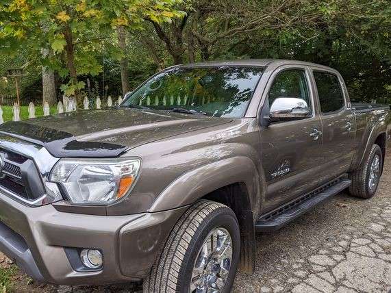

    MrsVT wasn't very happy with the frame breaking on the Avalanche, So she wanted another truck. This time a Taco with some ground clearance. A/T tires coming soon and it's pretty much a non-discript color that isn't going to attract attention. missusvt.
    It's a good 2 feet shorter than the Avalanche and a foot narrower. Much easier to maneuver around.
