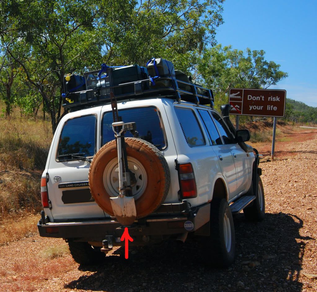

    So one small "issue" was that on the old rear bar the HiLift was attached with a dedicated bracket on the OUTSIDE of the wheel which mean't that I could strap my long handled shovel onto the jack safely for travel (as seen with a different shovel to the one I have now).....
    With the new (and in reality better) way the jack attaches there is no place for the shovel there in the back wheel (if I were more skilled there are mounting points on the opposite side of the wheel carrier to where the jack sits for attaching a big HF antenna and some brackets could be fabricated, but that is beyond my skill level and would be too costly to pay for) so with the roof rack being a permanent addition to this truck I did some reading and grabbed some LED lightbar mounts (to attach an LED light bar to the front of the rack) and some rubber holders for the shovel and bolted it all up today.....
    ....slightly harder than it should be as that shovel does not have a straight handle nor is it round but is an oblong shape. But IT IS a great shovel with which to dig out a truck (yep done it) and to me is almost perfect for the task so I wanted to retain it. I was actually surprised how well it all fitted up. I replaced the hardware that came with the ribber holders and cut some sleeves for where the bolts go through the brackets as they are made for much larger diameter bolts. I will add two large cable ties for extra security (both to make it harder to steal around town and in case of a failure at highway speed). Once I was offroad I wouldn't bother.

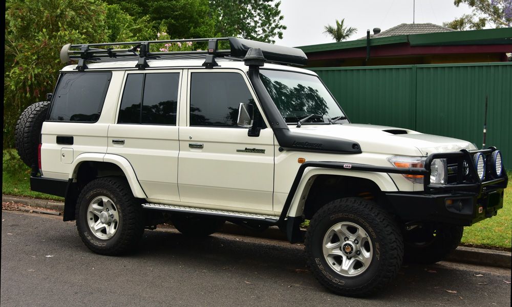

    Got the truck back from my local ARB place on Friday. Had the new one piece steel side rails and steps fitted up.... :D
    Ganado, Gator 45/70 and oldawg like this.

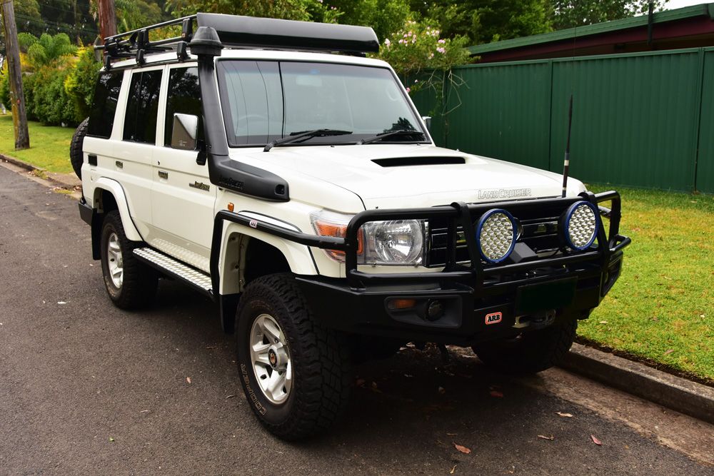

    Replaced the factory "snorkel" (in reality an unsealed raised air intake)....
    With a new fully sealed TJM jobby,,,
