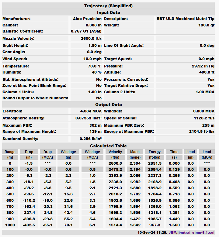

    With a G1 BC of .767, these 190gr. .308 bullets are astoundingly accurate.
    Of course, mine aren't still shiny as I have had this batch in storage for a while.

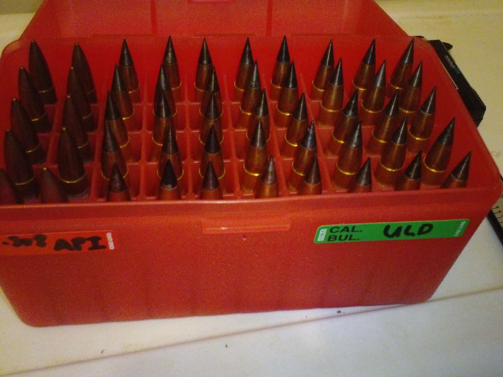

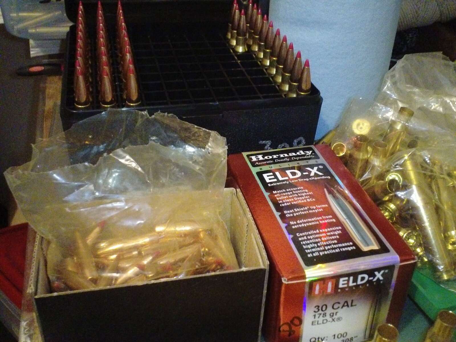

    DSC01229.JPG I'm currently reloading some ELD-X 178gr. and have just finished a batch of 190 gr. HPBT, got 200 finished up and boxed...
    DSC01227.JPG And this special batch of API on the left of the box with ULD steel tipped on the right.

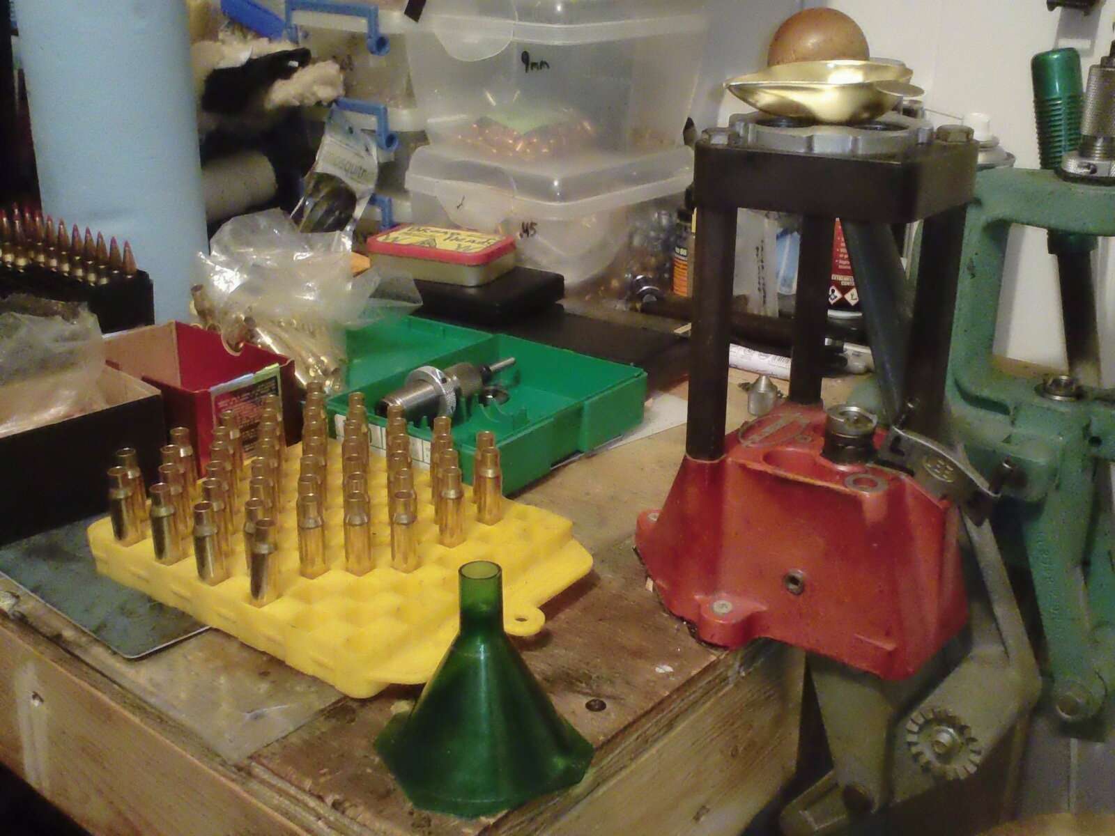

    I need to clean up the bench...a little messy.
