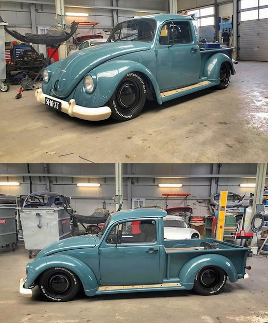

  1. Gator 45/70
    The magic mind of redneck-ism at it's finest!
    GrayGhost, Zimmy and SB21 like this.

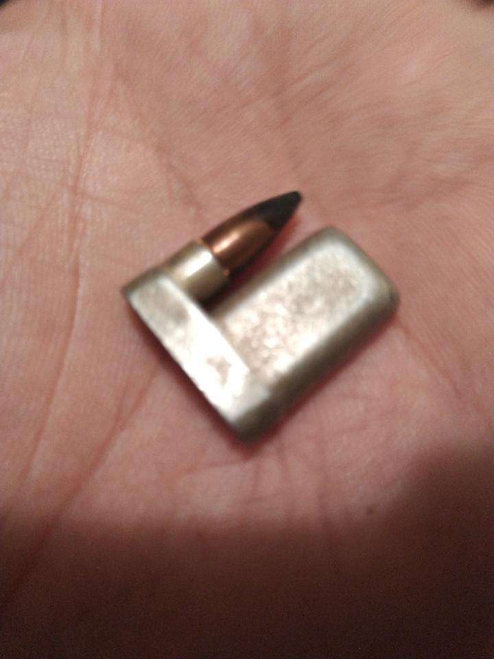

    I'll just leave this here.
    Not photoshop. That's a friend's hand and found while cleaning out a house for an estate sale.
    Ideas?

  6. aardbewoner
    aardbewoner judge a human on how he act,not on look and talk.
    Was a test ammo in the 70`s folded ammo 5.56x22 to find the most eficient shape.very rare!
    Gator 45/70, mechstdr and Zimmy like this.
  7. SB21
    I've been wondering why they didn't do that years ago . Never even crossed my mind to try and invent it myself . :(

  8. Zimmy
    Zimmy Wait, I'm not ready!
    I never could find shit on it. The man who's estate it was had been rumored at the Skunk Works and Area 51 (not the loony stuff) back in the day.

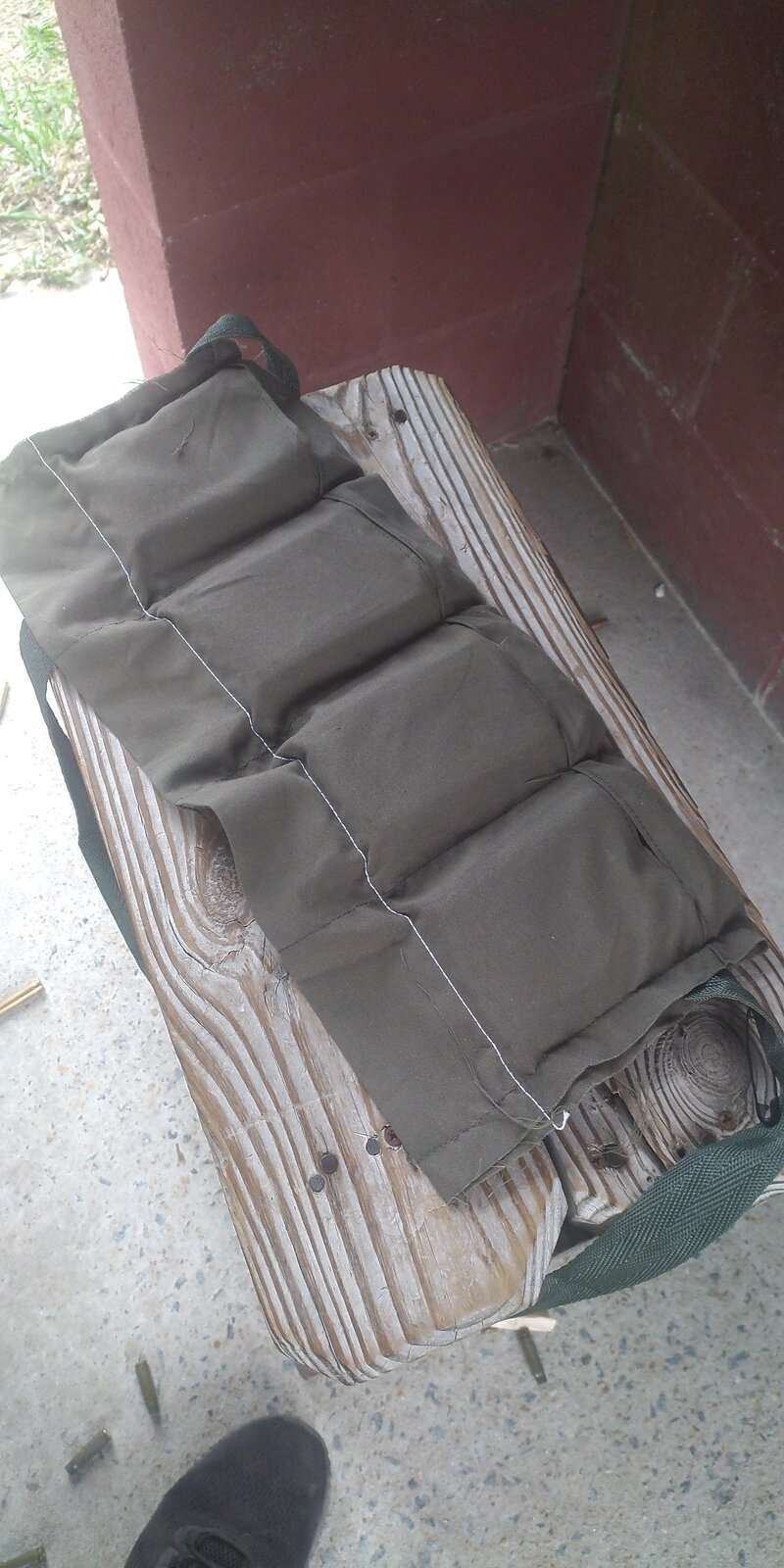

    Vietnam era bandoliers did double duty holding 20 round magazines.
    When we adopted the 30 round magazine the bandolier was too short. The solution was the white stitching you see across the pouches. It held the boxed ammo up where it was accessible. It also let the bandolier fit in the same ammo can as the old one.
    Once all the ammo was loaded into magazines the string could be pulled, the stitching would unravel and the pouches would be deep enough to hold a standard 30 round magazine.

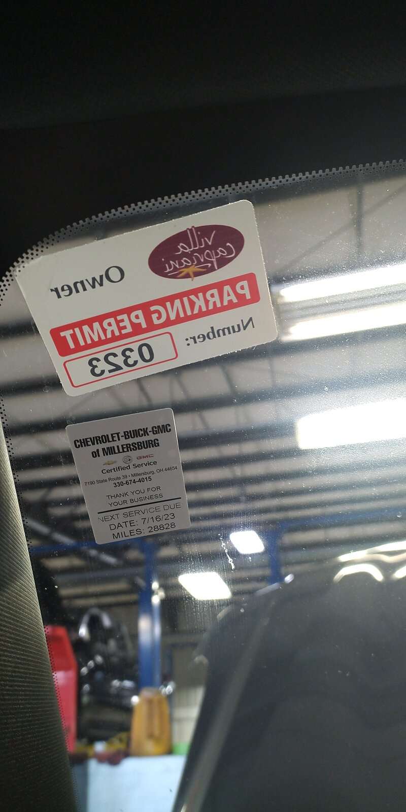

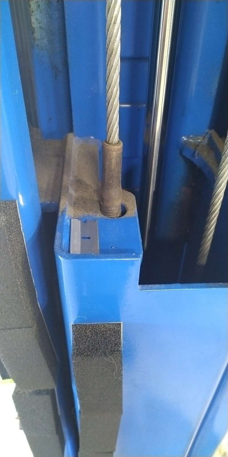

    When I need a razor blàde to scrape off pesky stickers I hate getting out to find one and then climbing back in. So I stage them on the lift within easy reach from the driver's seat.
    I know I'll never grab one by accident, because the spot where the blade sits had several years of undisturbed dust on it.:)

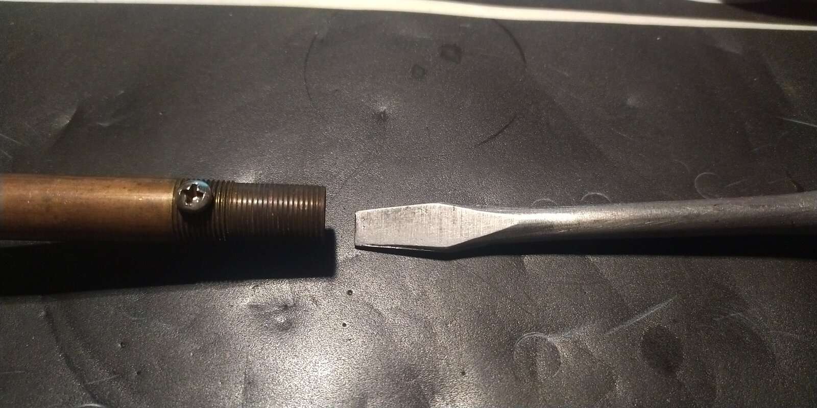

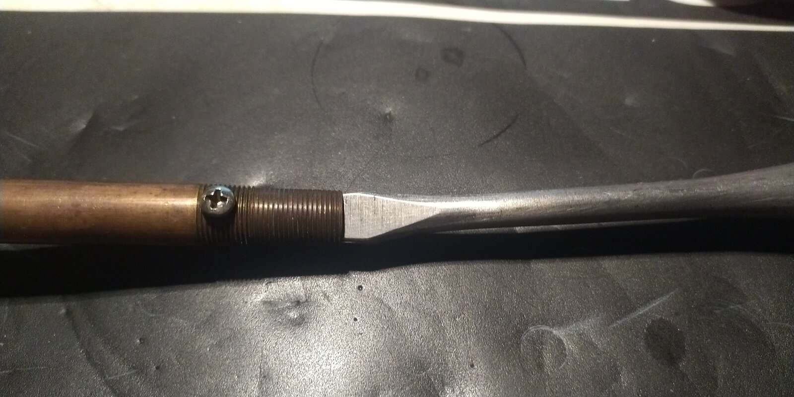

    Lantern and lamp tuning tip, but could be applied to other things. In this case let's say the mixing chamber on a lantern or a burner tube is loose. The threads aren't getting a good hold and the fit is wobbly.
    The threaded end of brass tube can be reshaped if out of round, or expanded if it's worn by using a big screwdriver. Insert the blade into the tube, apply a little pressure and rotate the screwdriver in the tube. Go slow, check the fit often. Apply a little more pressure until you get the desired fit.
    The rounded edge of the taper on many screwdrivers looks like it was made to do this job.
