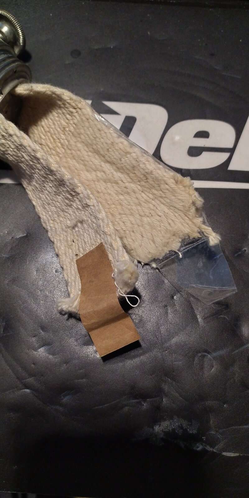

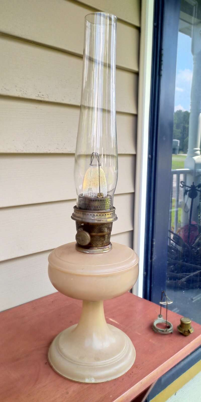

    I found this well used Aladdin Model A locally. I never knew the Model A existed, thinking the Model B followed the Model 12. A little research revealed that the Model A was released in 1932 and quickly redesigned into the Model B after customer complaints about the wick being difficult to replace. The lamp fired on the fuel that was in it and only needed a new wick and a good flush of the red dyed kerosene it had been fueled with. I fired it up to free the gummy kerosene residue so I could get it apart and started reading about this wick issue.
    IMG_20240615_154543.
    I got a new old stock wick so I could experience what a customer might have in 1932. I wouldn't say it's "difficult" to install a new wick in the Model A lamp. I'd call it nearly impossible. :mad: I fought with it for forty minutes and had it completely jammed up. Now I see why the Model A is just a footnote in Aladdin history.
    The fix? Modern clear packing tape on both sides of the wick with an extended tail allowed for a lightning fast installation with no snags at all. Just peel the tape off once it's installed.
    This trick will work on any lamp with a fuzzy wick or a gear mechanism that gets caught in the wick.

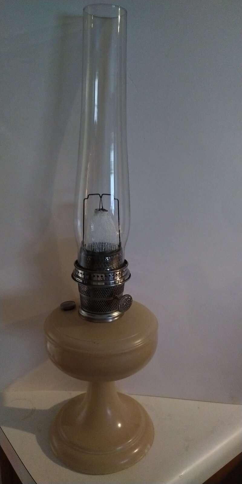

    IMG_20240701_154818.
    The lamp cleaned up just about like new. New wick, fresh fuel, new mantle. You'd never know it's 92 years old.

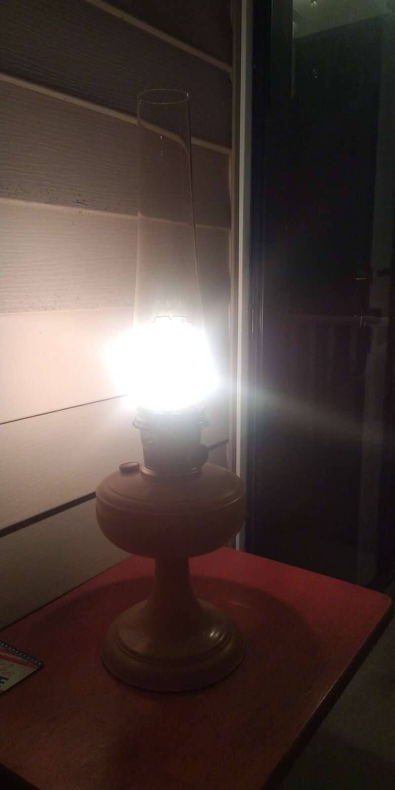

    IMG_20240701_165632.
    Makes the same light today that it did 92 years ago. Try that with a battery appliance.
