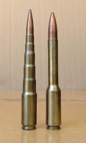

    tis a strange bird ..
    the .30 giraffe cartridge is on the right
    the googz is havin issues findin the rifle that goes with it

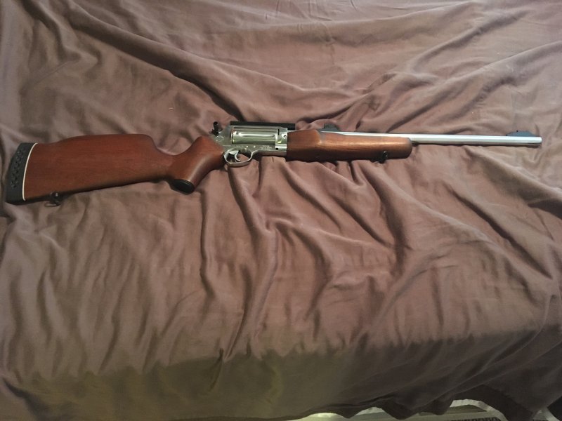

    I should have added the caveat; Some arms are not able to chamber all the listed chamberings ( lever guns come to mind) I posted before, but many single shots can! The only real concern is throat build up of lead and powder fouling, but unless you shoot a lot of say .45 Colt, your not really going to have any issues! The larger chamberings like .45/70 and 90 will lead much faster, and as long you have a concentric chamber to bore, shouldn't cause issues! Makes for an awfully handy arrangement when you have that much variance in power with just one weapon! I always likes the idea of the Taurus Circuit Judge revolving rifle, but to my mind, it's just not practical unless it could take .45/70, then it would be a super seller, I would be all over it!
    Not mine!

    I'm sure somebody could make a rifle that'd chamber the .30 Giraffe Magnum ... but who needs a double shouldered, belted magnum with a rebated rim?
