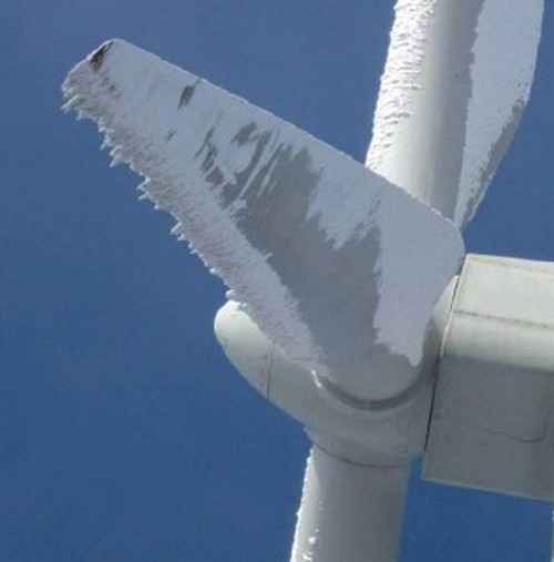

It isn't the lubes that are the problem, it's the accretion of ice that mucks up the fans, throws balance way off and adds large weight to the blades and hubs. They have to shut them down to keep them in one piece. I suppose they could install a deicing system similar to aircraft, but, I can see an impractical side to that brain pharte.
Reckon heater strips inside those blades are beyond the realm of possibility? Hell, I'd duct tape a light saber on em' It heats up the air and melts boolits flying at you and probably cooks the birds as they hit the blades, Hunger problems solved !
Well Im not sure I buy the grease thing, usually its a safety thing, if a customer purchases tropic turbines and tries to run them in artic temps it wont work so good and vice versa. If they site them close to road ways in Texas then ice can destroy a car, I had a blade dump ce near me years ago and it was enough to bury 2 full size chevy pickups completely. The turbines have no problem running in the winter, look at Minnesota been running fine for years in below zero every winter. Texas just isnt prepared and making a decision for winter operations they ran out of the ability to get natural gas moving . Pipelines in Texas don’t use cold insulation —so things were freezing., So there is that too. If a state that knows pipe line better than anyone would insulate they wouldnt have a issue or not as large as the current one, our stuff runs in the cold out here.
It was explained to me, that it was not likely a grease issue, but more of a unbalanced condition of Ice & Snow on the Blades... I wonder if a “Wing deIcer System is or could be, incorporated in the Blades of the Northern tier of Wind Machines... In Texas, this type of weather is NOT common, but hardly unknown, either.. Bout once ever 10 years or so... But It shows very poor planning, to rely on Wind & Solar for base Load. generation, in a place where heavy Snow can disable 20%. of your base Loading capacity, with little or no chance of intertie connections. to other outside Grids, like Texas has... Oh well it is their issue and NOT mine...

There has to be more to the story, I've seen almost a foot thick ice and they don't stop, just don't build as much power like a plane wing, unless they had them off line before it hit for a PPA thing, the feds like to shut them off alot at times cause the grid is shit https://www.vestas.com/~/media/vest...018_brochure_vestas_antiicingsystem_final.pdf
As always, there's more. Case extant, I somehow think, but cannot know, that the operator didn't buy the deicing systems for those units installed in a "warm" climate. Without deicing, I still say that the loss of lift will make the machines essentially useless when iced up and dangerously overload the bearings. That ignores the safety issue. Never have seen it, but I can visualize a couple lumps of ice flying off and smushing something as well as taking the blades out of balance and simply shaking the whole tower. I know the rotors have brakes, but no idea how fast they can stop the rotation. And, of course, there was no spinning reserve to bring up.
I've never seen one of these super duper monster wind turbines but.... I have seen out of balanced ceiling fan blades flopping around and a helicopter that knocked a foot of the blade off. When it hit the Gulf and proceeded to beat the hell out of what was left of the blades. Throwing blade debris a 100 yds or so, Also ripped the turbine out as it rolled over
They will stop before one revolution of the rotor completes 360. On the balance of these if its off by a predetermined amount measured by the turbine it will auto shutdown due to edge wise vibration a safety feature. I've never seen ice stop these, I've worked on them in 11 states and in the coldest of cold winters 07 in Minnesota 35-40 below it never happened. at Hermiston Oregon in the fog the ice gets really thick, they don't stop. there is more to the story in Texas, someone might be making a point, or someone shut them down right before the freeze hit and weighted the lower blade and couldn't take off... there is more to this story, 15 years daily 2 polar vortexes and many ice storms 5 northern states and never seen it. but who knows maybe there is a first time and i was asleep at the wheel
