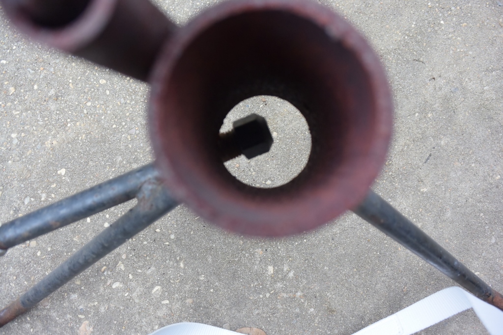

  10. Gator 45/70
    12'' tall
    Pipe is 4'' with a 2'' air gap to the bottom of pot
    burner 001 (1024x768).
    burner 006 (1024x768).
    kellory likes this.
  11. Gator 45/70
    Mic'ed at .061
    1/4'' pipe is even with the bottom of 2'' pipe.
    Pretty simple, But works!
    burner 008 (1024x768).
    burner 010 (1024x768).

    OK, this has taken a while, due to restrictions of when I can use the welders, and I have taken a few "liberties" with the suggested design, but the burner is complete, and works great. I had #7 of WW lead, liquid in about 15-20 minutes. (And that is with a good breeze blowing). Pics to follow: IMG_20150307_182204272. i started with two rings cut from springs, welded, heated and hammered to lay flat. And four rods cut from scrap, and an idea of what I wanted it to look like. IMG_20150307_183652194. i used a coat hanger to form the shape I chose, and heated and bent the legs accordingly. IMG_20150307_184845578. i then had to wait for the welder. Once welded at the lower ring, it was time for more heating and bending. IMG_20150314_111540291. IMG_20150314_112003599. IMG_20150314_112753157. IMG_20150316_202916218. followed by welding in the upper ring and cutting back the grill to fit the plumber's pot. Then I needed a riser pipe, and cleaned up and cut a piece of 1" pipe. IMG_20150321_105008223. IMG_20150321_105354535. IMG_20150321_110045935. IMG_20150321_110914350. IMG_20150321_110532098. IMG_20150321_111942092. but after a hand fit and fitting the gas jet, I felt the proportions were off, so cut a piece of 2" heavy wall pipe from scrap and fitted and welder it to the leg. IMG_20150323_163935798. IMG_20150323_163926932. IMG_20150323_163926932. I then heated and reshaped the upper ring out of level (you will see why later) IMG_20150323_171829423. IMG_20150321_102908593. IMG_20150321_102613131. IMG_20150321_102930631. the gas portion of the burner, consists of a 1/4" brake line section, a matching union, a cap insert (this part was drilled for the orifice) a ten foot section of reinforced rubber hose, a couple of clamps, one barb fitting union, and a regulator I snagged at the recycling center when I was there. Total cost for this section about $8. Now, back to the burner. I needed a method of joining the burner stand and the burner gas feed, but did not want to weld it. IMG_20150331_203122459. so I fitted a sleeve and soddered it to the feed line. The sleeved bracket and a matching bracket lock to the leg with a through bolt and a wing but. Burner can be assembled or disassembled in seconds. Now for the test burn.
    Due to the breeze, I added a wind screen (my fire ring) IMG_20150328_163855693. IMG_20150328_170623407. IMG_20150328_170827992. IMG_20150328_171130088. i then swapped the pot for the skillet, added a hand full of the skimmings from cleaning up the lead (clips, steel weights, zinc that got past me) and you will now see the reason for the slightly out of level top ring. IMG_20150328_174047567. the lead being the first to melt, rolled out from under the scrap, and rolled down hill, separating almost completely on it's own. This lead can go back into the pot.
    It's time for a clean up and a paint job. A quick scrub down with steel wool, a touch or two with a grinder, and a couple of coats of high heat furnace black paint. (Another $5.00 item. Total material costs about $13.00. IMG_20150331_203151729.
