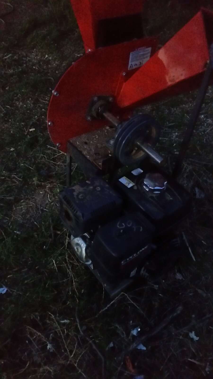

  1. oil pan 4
    It's coming along good.

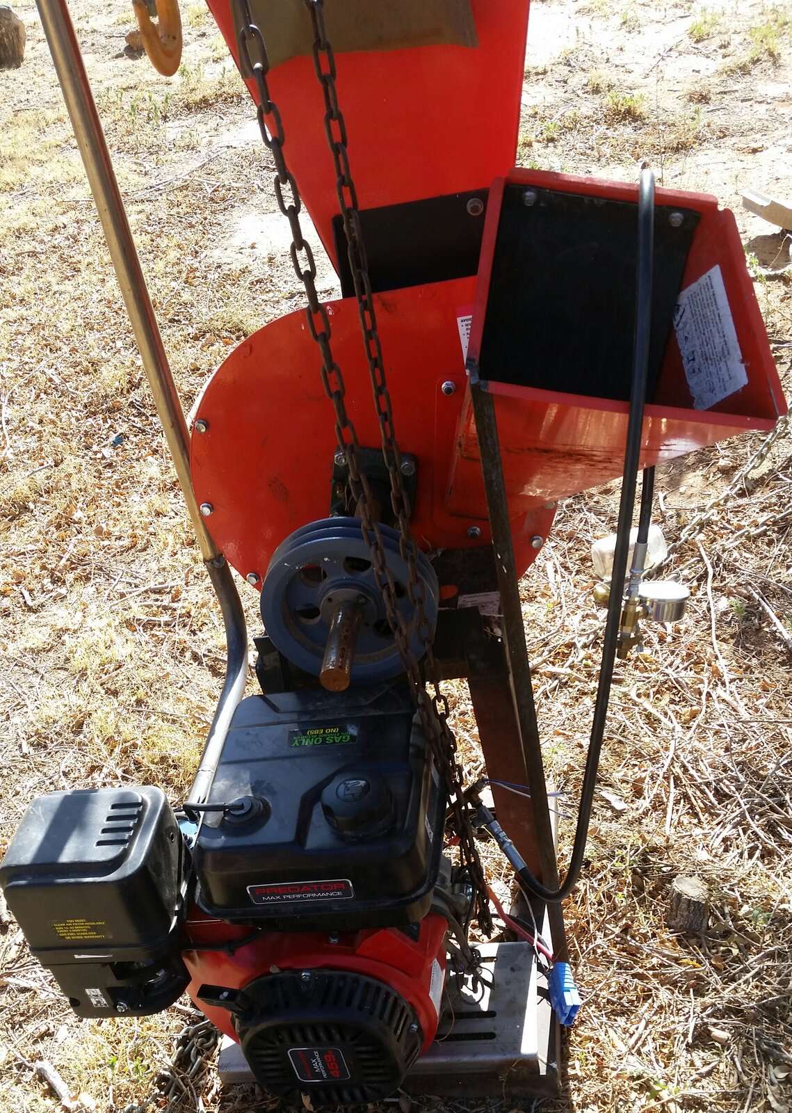

    I got the 1.25 inch shaft turned town about 0.88'' (originally it was 7/8'') and press fit it into the cutter head.
    For the cutter drive pulley I found a solid cast iron 200mm or 8inch 3belt cast iron 2012 taper lock pulley someone wanted gone shipped for $22.
    A 1.25 inch 2012 taper lock is like $30.
    2012 and 1610 are my preferred taper lock sizes.
    For the engine I'll do a 7 inch pulley.
    That will make the cutter speed about 3,100rpm.

  2. oil pan 4
    I turned down and press fit a 1.25 inch 4130 shaft into the old cutter head and welded it on. Did tig then stick weld over top of it. Yeah its not coming off.
    It can chip dry firewood now barely slowing down. The cutter is driven about 80% of engine speed.
    It can easily have 2 people feeding it. Twigs and leaves into the shredder and small sticks like I normally wood chip into the chipper. With the 6.5hp engine it was chip or shred, not both.
    I think I'll mod the single cutter head to make it a 2 cutter head and put a predator 459cc on there. The old Honda gx390 really isn't lacking much if any power.
    I bought the motor moint plate that will fit big block 1cyl and most V-twins.
    I need to put a guard on it.

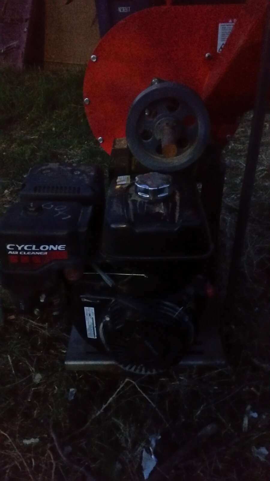

  3. oil pan 4
    The old gx390 is burning a lot of oil.
    So I retired it, for now and replaced it with a predator 459cc. I installed the 6,000 to 8,000 feet above sea level jet (I'm at 4,000ft). The stock/sea level jet is a size 100. The 3,000 to 6,000ft jet is a 97 and the 6 to 8 thousand ft high jet is a 95.
    With the 95 it wants to sputter and die at first, till it warms up a bit maybe 10 seconds of half choke and another 20 seconds of at least fast idle (using ethanol free gas).
    I cranked the engine over with my DC amp clamp, it was reading 55 amps.

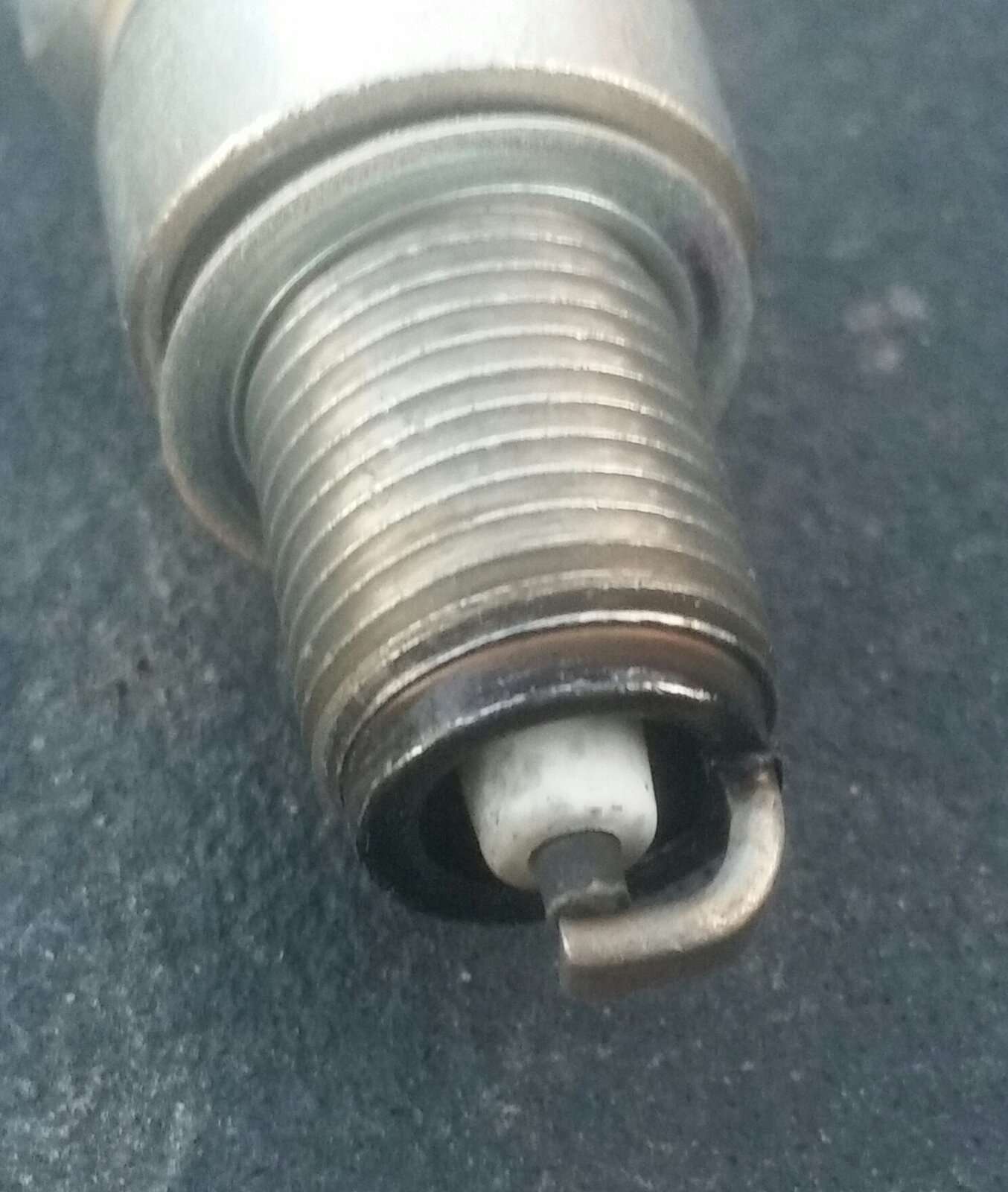

  5. oil pan 4
    The spark plug after a few gallons of gas.

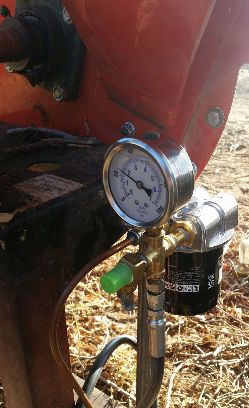

  14. oil pan 4
    I sent the oil sample. off to be tested and got the results back, 3hrs of total run time and 3hrs total on the oil the oil has 30ppm of iron and 13ppm of aluminum, with out the filter. Which is more than I have ever seen on an oil test.
    The lab says to run it, like that for 10 to 15 more hours... Well it's got the filter on it now. There's already been a substantial reduction of metal flakes in the oil. Just running it for 20 minutes at idle with the oil bypass going wide open. Going wide open the oil was being filtered about 4 times per minute.
    I added a valve to the return side of the filter to slow the flow and keep the pressure up. I start it, open it up and allow 3 to 5psi of oil pressure to bleed off to the filter.
    With the oil restrictor valve bleeding off that 3 to 5 psi the oil is being filtered about once a minute.
    The manual says to change the oil every 20hours. The idea behind adding the filter is to increase oil change time from 20hrs to 100 to 200hrs and have the engine last a lot longer.
    CraftyMofo likes this.
  15. oil pan 4
    I added a oil temperature gauge to the oil filter, it's only hitting 160f so don't need an oil cooler. The way wood chipper engines run they're usually not running 3,800rpm at wide open throttle. More like 3,000-2,500rpm with plenty of unloaded and light load time.

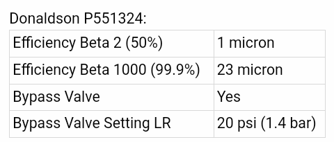

    The perfect oil filter for 13/16-16 thread "Chevy" filter head:
