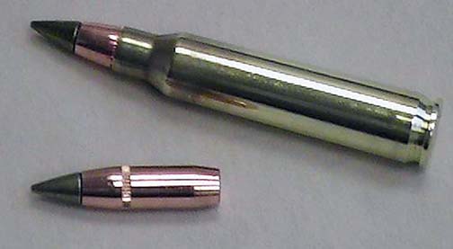

    Um, correct me if I'm wrong but M855/SS109 IS the standard. It meets VERY specific design tolerances. If it has a longer projectile, how exactly is it M855?
    This came from the US Army Research Lab (same info in a number of documents there on M855).
    Length (mm) - 23.057
    Mass, m(g) - 4.04
    Center of Gravity, XCG (mm from nose) - 14.279
    Axial Moment of Inertia, Ix(g-cm2) - 0.1416
    Transverse Moment of Inertia, Iy(g-cm2) - 1.138
    upload_2015-2-20_19-17-27.
    Here we have a FIXED length. I won't quote Wikipedia (I hate doing that) but the overall length is FIXED as well for the round. It isn't "about" a certain length or "around", it's FIXED. If you can "see" that the projectile is longer, technically all you can see is more exposed projectile (unless they have a cut away...which they don't), which means they have monkeyed with other dimensions.
    I'm sorry, rant off, it's just that ads like that drive me up the wall. There's a standard, stick to it if you are going to use the "name". If you do something different (longer projectile, out of spec brass, whatever) it's NOT what you are calling it!
