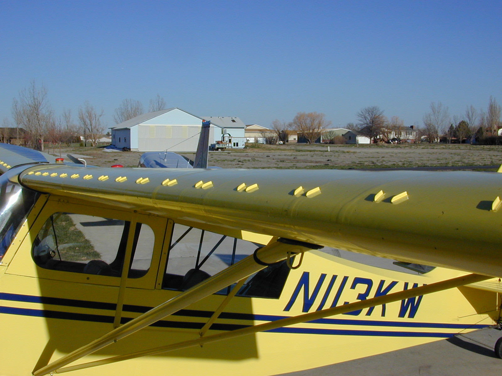

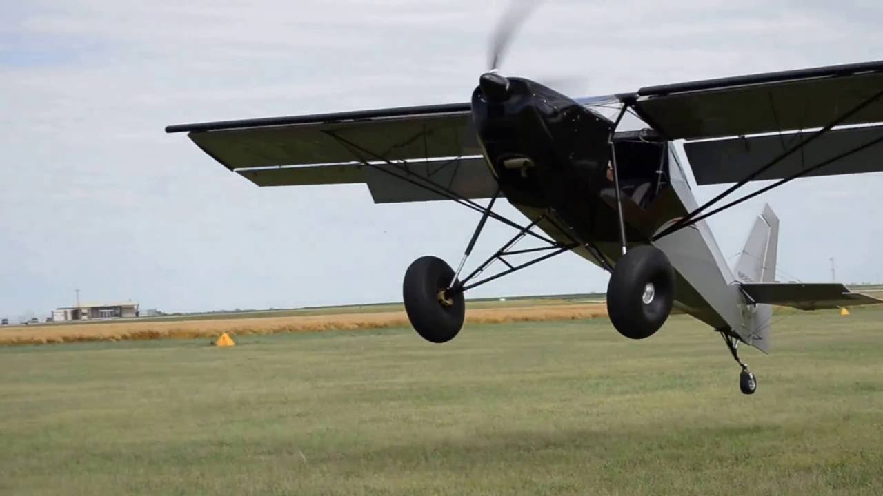

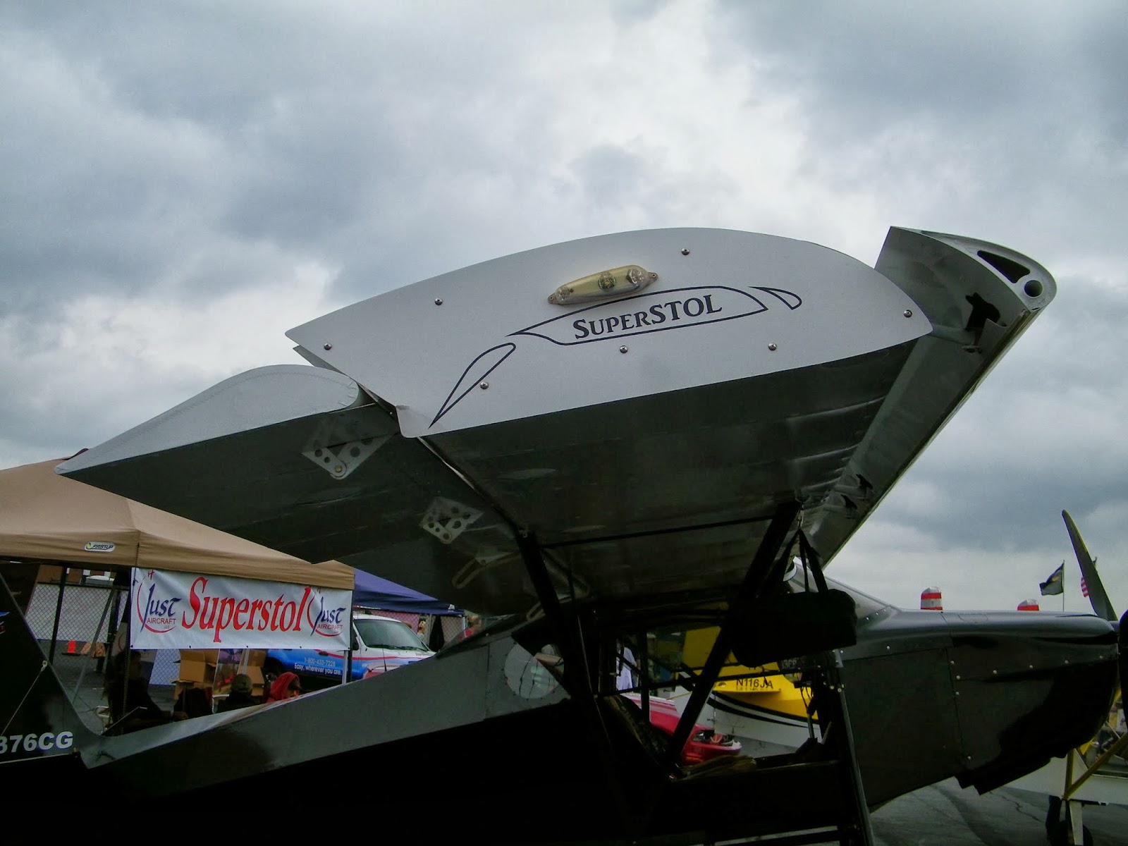

There are many other benefits to this technology, far beyond the high speed airliners and even fighter aircraft! Have a look! We call them "Tip Fence's" and while they work the exact same way, they also produce some other very useful advantages! Besides maximizing a wings lift by preventing the two air streams around the wing from mixing around the wings tip before they converge and depart the wings trailing edge, they also provide additional yaw stability, help prevent 'Tip Stalls" and tighten up the rudders authority, and they also boost the aileron effectiveness, especially at the very low speeds we typically enjoy flying at! Many of us have gone even further in adding mid span fence's to our wings, this has the benefits of boosting the control surfaces authority further, as well as increasing the lift to weight to speed ratio of the flaps system, as well as tightening the yaw divergence even further, AND, it also allows one to "Hit the brakes" by kicking hard rudder while maintaining wings level flight, these additions provide much needed aerodynamic drag to slow one down quickly, usually called a side slip. I went even further on my build, I also added fence's to my wings joint where it meets the fuselage, further directing and controlling the airflow over the top surface of my wings and pinning it to the flaps which maximizes the amount of lift my system can generate, which for me, lowers the speed at which my wings will actually stall at, far below what an airframe like mine would normally stop flying at! Real World testing has proved this beyond all question, with all the goodies, I went from flaps up power off stall of 26 MPH to a 23 MPH stall, and it never really actually stalls, it naturally drops the nose and immediately starts accelerating and starts flying again! With max landing flaps, my stall happened around 21 MPH before all the tricks, and now, with everything, it stalls at the unbelievably slow speed of 13MPH! I can literally land with the brakes locked and come to a complete stop inside the length of the airframe! Yes, these things really do work that good, and I have full control of the aircraft all the way to the stall at all times! With the addition of leading edge slats, my airplane became stall proof, it's impossible to actually stall, it simply drops it's nose and starts flying again all on it's own! I can shut the engine off and take a nap and it will eventually land it's self all with out me touching the controls! Might not land with the wings level, but it will land! This makes emergency landings a much safer prospect, even if I were forced to put it in the trees, I'm not going to hit very hard, which increases my chances of walking away mostly unharmed! There are also Vortex Generators we all love to add to our planes wings and tail surfaces, these do exactly what the name says, generate small powerful vortexes which increases lift, accelerating the air flow over the top of the wings, and scrubs the wings surface, breaking up the laminar flow and increasing the effectiveness of the flight controls at very low air speeds, with out a penalty in cruise speeds or higher! These can be added to many different parts of the aircraft, usually you see them on the top leading edge of the wings, and the bottom mid span of the horizontal stabilizer as well as ether side of the vertical stabilizer forward of the rudder! I also have them in my flap gaps and the aileron gaps on mine, increasing the air flow and effectiveness of those by quite a bit! It used to be VERY common to see these little Vortex Generators on high performance aircraft, but they do produce drag at very high speeds which despite the advantages they offer, were considered a penalty the operators didn't want to have to pay, so other tech was needed to compensate, but no other tech could match what V.G's provided, and you still do see them on some airframes, most notably on the U.S. Air Force's B-1 Bomber!
I always enjoy watching those great big rubber doughnuts landing at a near walk. Makes landing in the rough a new experience.
