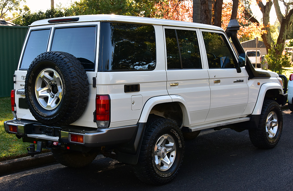

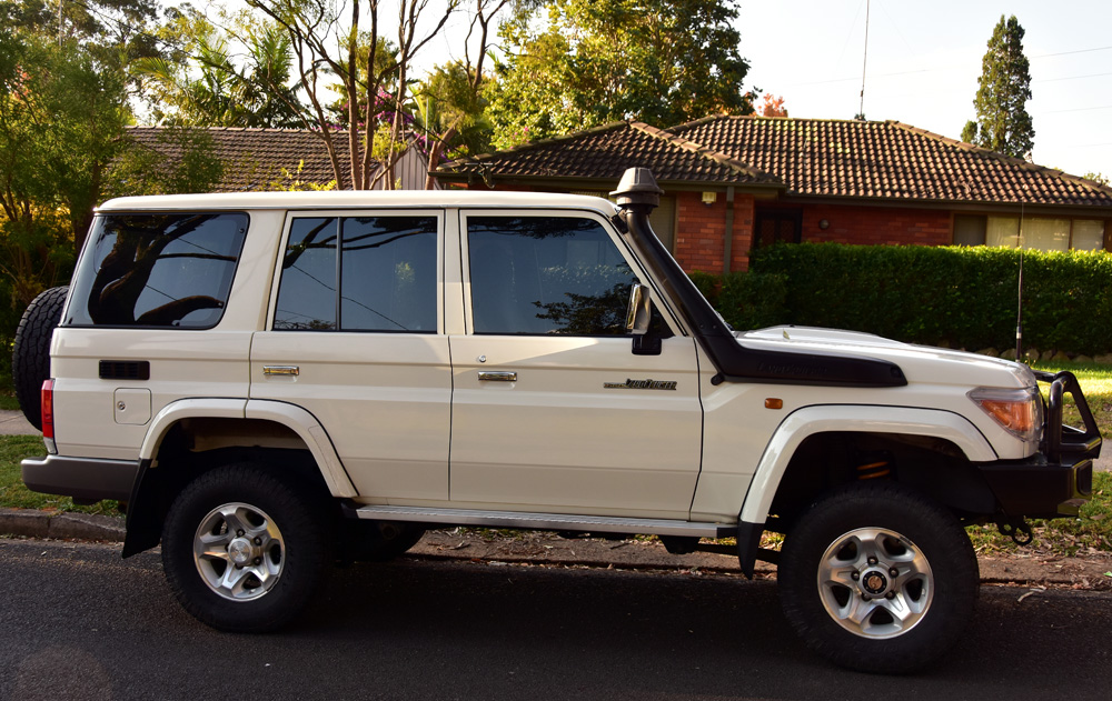

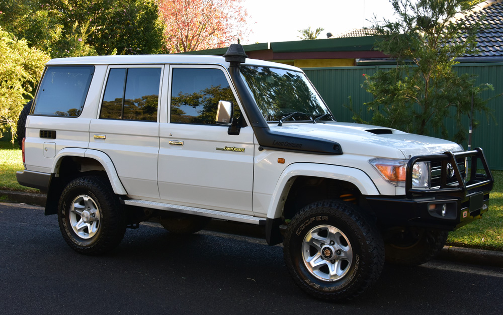

  5. Andy the Aussie
    So the starting point...
    Day we arrived home (a few weeks ago)....
    And some I snapped today....
    ....since arriving and today about the only change I have made was swapping the Cooper tyres off my 80Series and onto this one.

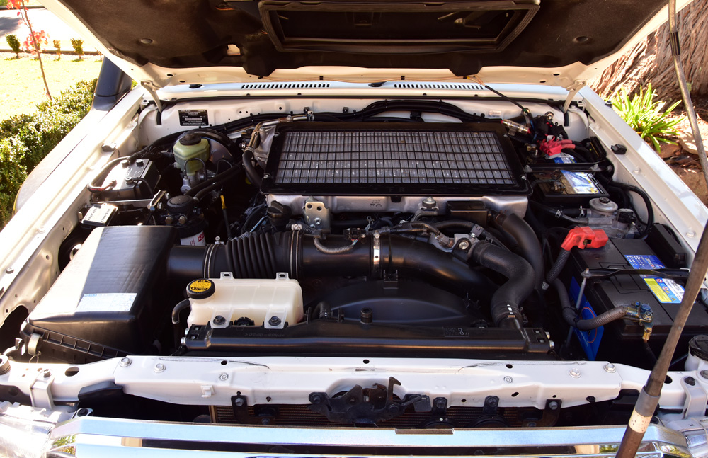

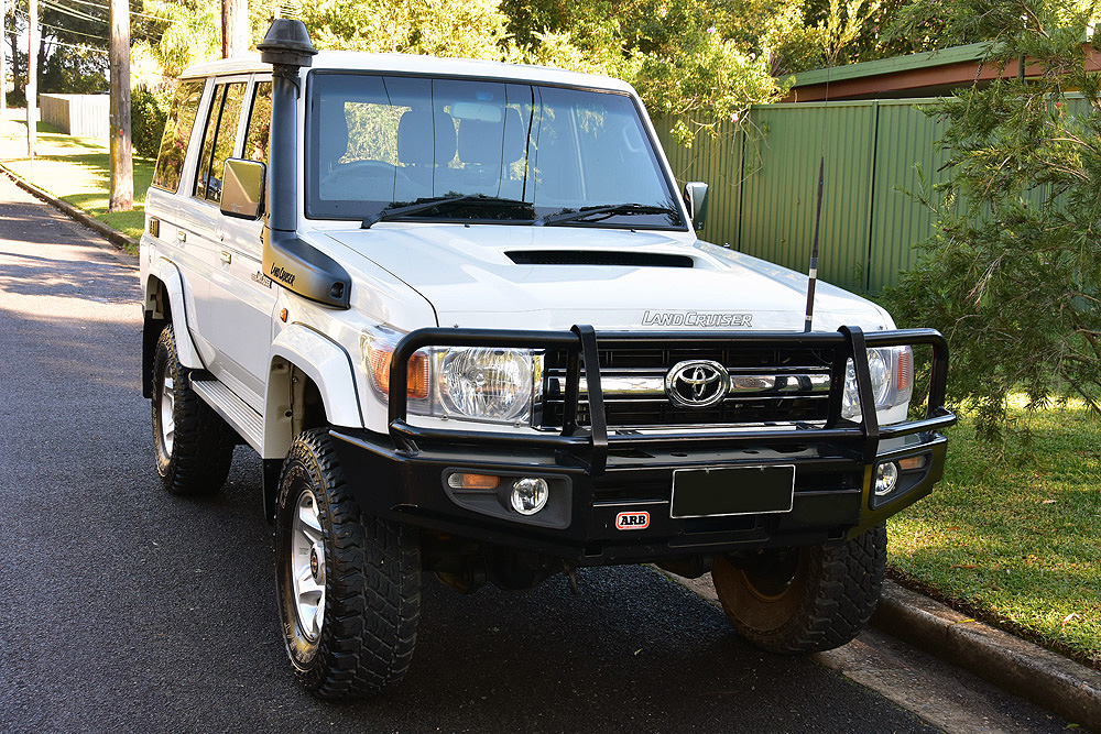

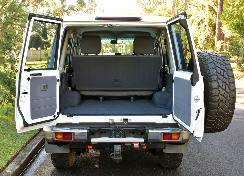

    So this one looks about stock but the prior owner spent some $$s on it to make it suit his needs. He and his wife are retired and this has been used solely to pull their caravan north a couple of times a year. Pretty much all his modifications were with this in mind. Being a factory GXL package it comes standard with front and rear Diff Locks (switch operated from the dash) and (a negative to me) carpet ! He added a reversing camera (aimed to use hooking up his van one out), a UHF radio, windows are tinted, several power outlets inside and out (for both fridges and running the van electricals from the truck), an engine monitoring system (the ECS type that plugs into the factory diagnostic port) and a temp gauge for the fridge about round out the internal changes (oh and about $600 in canvas seat covers).
    He spent more $s elsewhere. Under the front there is a dual battery system with a management unit (allowing it to charge from the alternator, solar or any combination of these), fuel pre-filtering system and an electric brake controller (won't ever need that). He also added a three plus inch stainless exhaust system from engine to tail and has it all sitting up on a set of HEEEEEAAAAAVY Ironman springs and Foam Pro Shocks. Above the back springs he has also added a set of airbags to take up/level any extra load. The back springs are perhaps my biggest issue, they are designed to hold up a freaking big caravan when hitched, so even dropping the airbags down to a 3psi holding pressure it is still harsh in the back !!!! I will bide my time before and decisions of changing these springs and see how they go when I sling some of the weight off the back I have in mind.

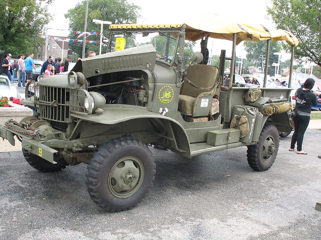

  14. Ura-Ki
    I gotta go Old School with my Off Road Rigs! 1942 Dodge PowerWagon WC-22
    ( Not Mine)
    DKR, Dark Wolf, Sapper John and 7 others like this.
