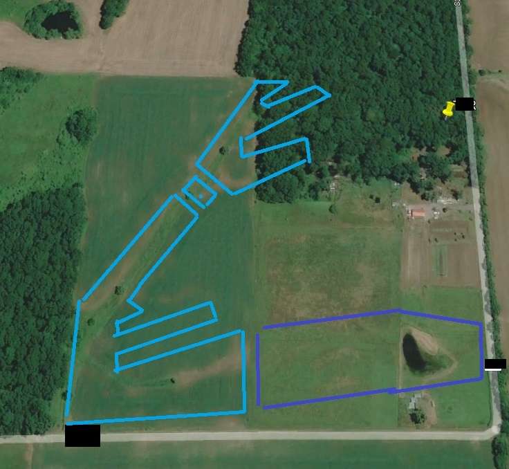

    LOL I really wish Google Earth would update my picture :) The Sat passes over us I guess ever 5 years taking pictures. So it should update this year. In the meantime I use my digital crayons :) The light blue is the Lake and two ponds I built last year. The Dark blue is the one I had planned on spending the summer building this year. That one got pushed to next year.
    I actually own 160 acre square comprised of four 40 acres tracts. What I call the primary is the South East 40 acre square. I have another 20 acre tract a mile North up the gravel road that is where the cell tower and their leases are and a big gravel lot that I unload semi deliveries at and it makes some hay. The two North 40 tracts are mostly arable ag land that I 2/3 -1/3 Crop Lease. The SW Tract has a 14x24 small hunting cabin that I lease to 3 guys from out of State for the Deer and Turkey hunting on that 40 and mow it for hay once per year. I bought the SW tract about a year ago, I got a first right of refusal fair market valuecontract from the previous owner in exchange for a Electric and water easement. Fair Market value was painful and I am NOT going to buy anymore LAND! That burned me for $6500 per acre. I bought the original SE quarter 40 for $1100 Per acre in 2008, the NE Quarter in 2010 for $2500 per, The NW in 2014 for $4200 per, The 20 up by the State Highway for $800 per in 2007. And the SW 40 in 2022 for $6500 per. Rural land whether wood or arable AG is only going to keep getting more Expensive and at a faster pace!
