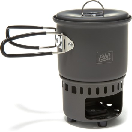

    What about an Esbit stove? The image above shows the problem. As delivered, it pretty much sucks for smaller pots/cups. Forget ever using a Trangia or other (soda can based) alcohol burner.
    I did mod the Esbit stove as shown below, and now can use Esbit tabs, and small sticks, in a pinch. The wood doesn't burn all that well, owing IMO, a real lack of draft.
    Here is the now modded Esbit, works with any pot/cup I own, but still holds no chance at ever using an alky burner.
    BTW - the new(ish) Esbit pot/stove with the Trangia knock-off burner system (below) does pretty much everything.
    Everything, that is, that the Trangia mini does, and is designed to burn alky in a Trangia knock-off at only twice (or more) the cost - and is marginal with wood burning.... I would still recommend it over the Mini for anyone starting out. But. While the new Esbit will work with other pots - they must be as large or larger than the 470mL pot that comes with the system.
