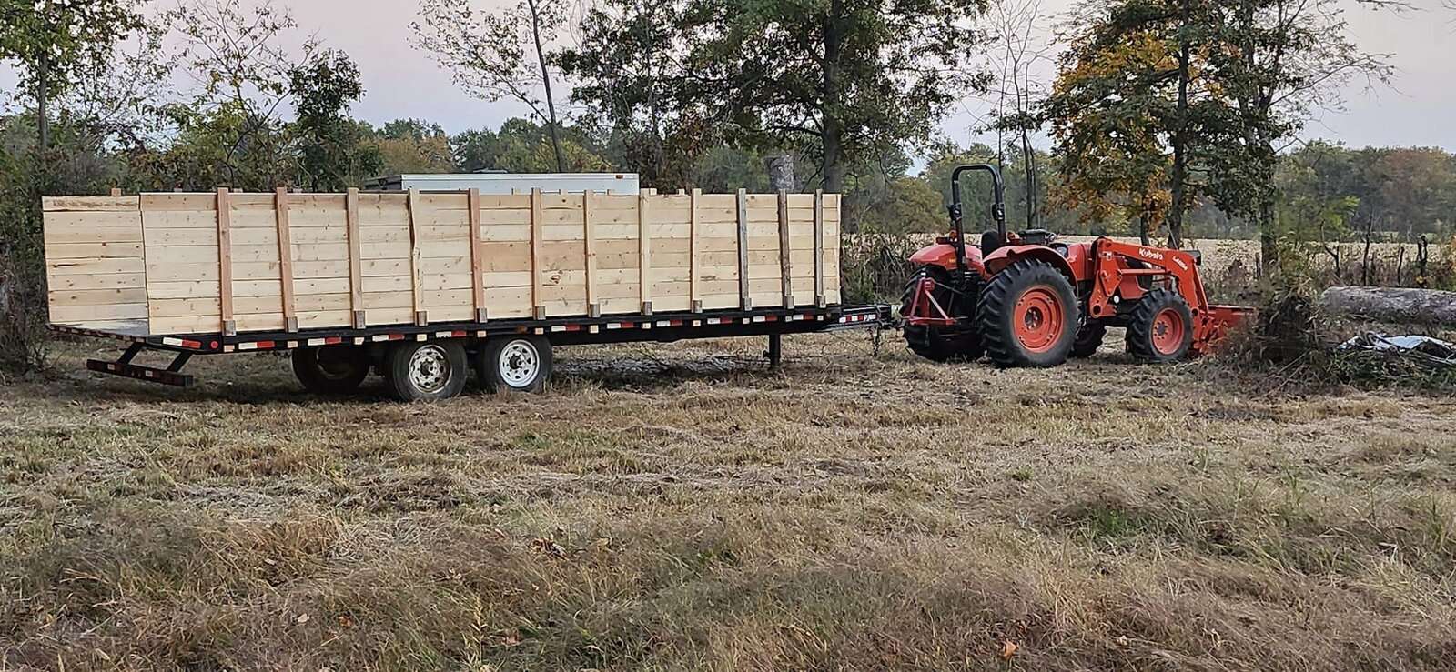

    I got a wild hair and had some spare 2x6s and 2x4 floating around. This is the 24' Tilt Deck I bought last spring. Got one side done this morning and started on the other side before I took a lunch break. It lifts out of the pockets in one big piece LOL Will have a top flat board the length with Eye Bolts on the ends and center and just hook the chains on the tractor loader hook and lift it out center of mass. So I can switch from stake sides to flatbed fairly easily. Going to hit it with several coats of Deck Sealer since I didn't have treated lumber laying around.

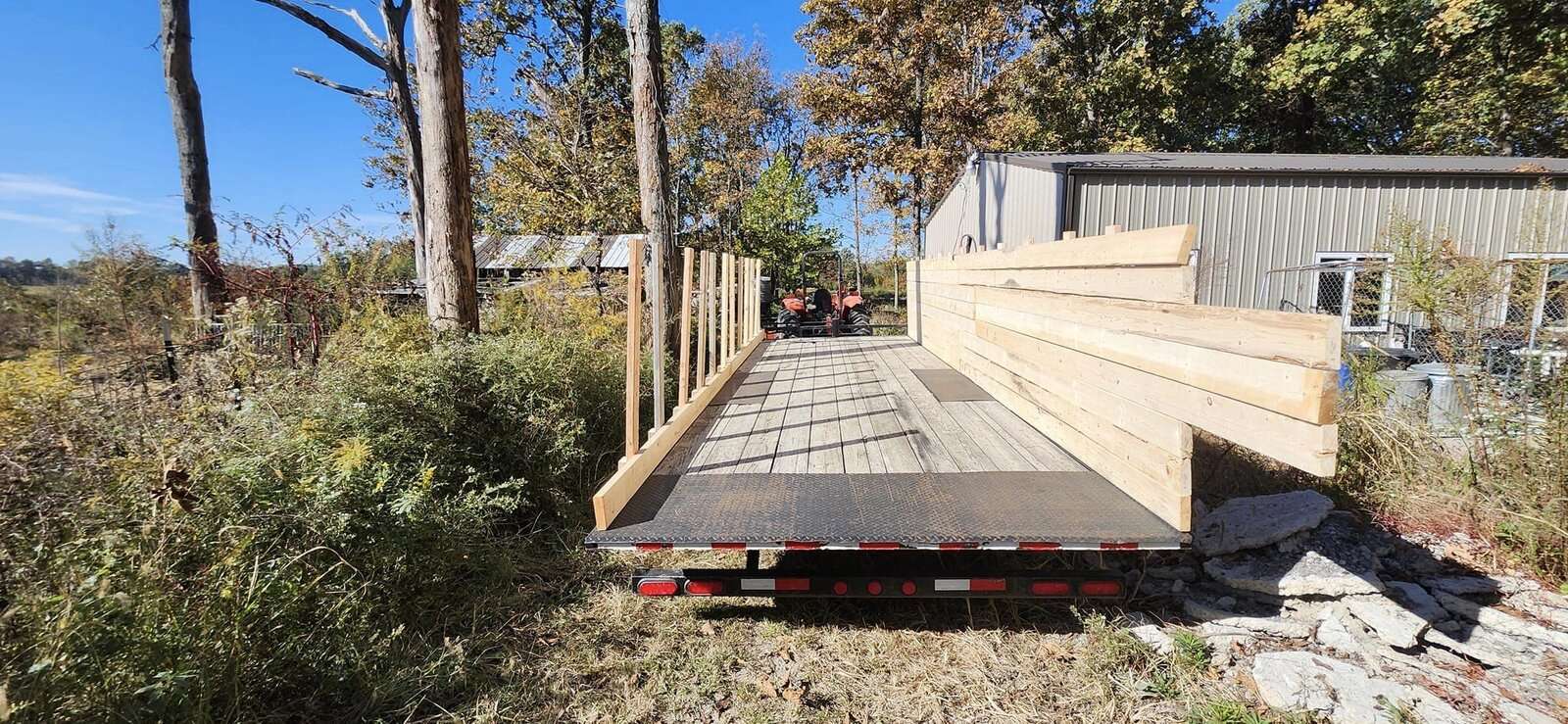

    I had a bunch of 2x6 14s and 16s left over from doing the inside of the house. Enough to go 48" on the sides with 2" above to put cross hoops on to stabilize the sides and put roll over rag top on it.

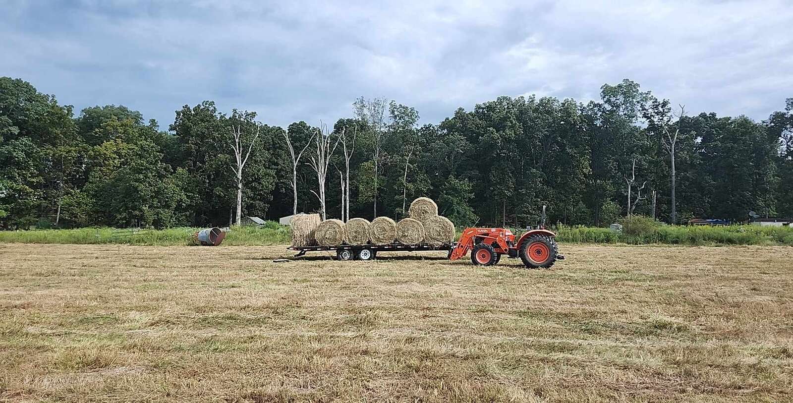

    Makes a great hay delivery trailer to as flatbed it can handle 15 1000 pound round bales or 10 1500 pounders. Real handy for delivering to the customers that don't always have a loader tractor on site. Just tilt the deck up and they roll right off the end :) I did have to beef the hydraulics and cylinder up on it though to get it to lift the load without straining and petering out half way raised.

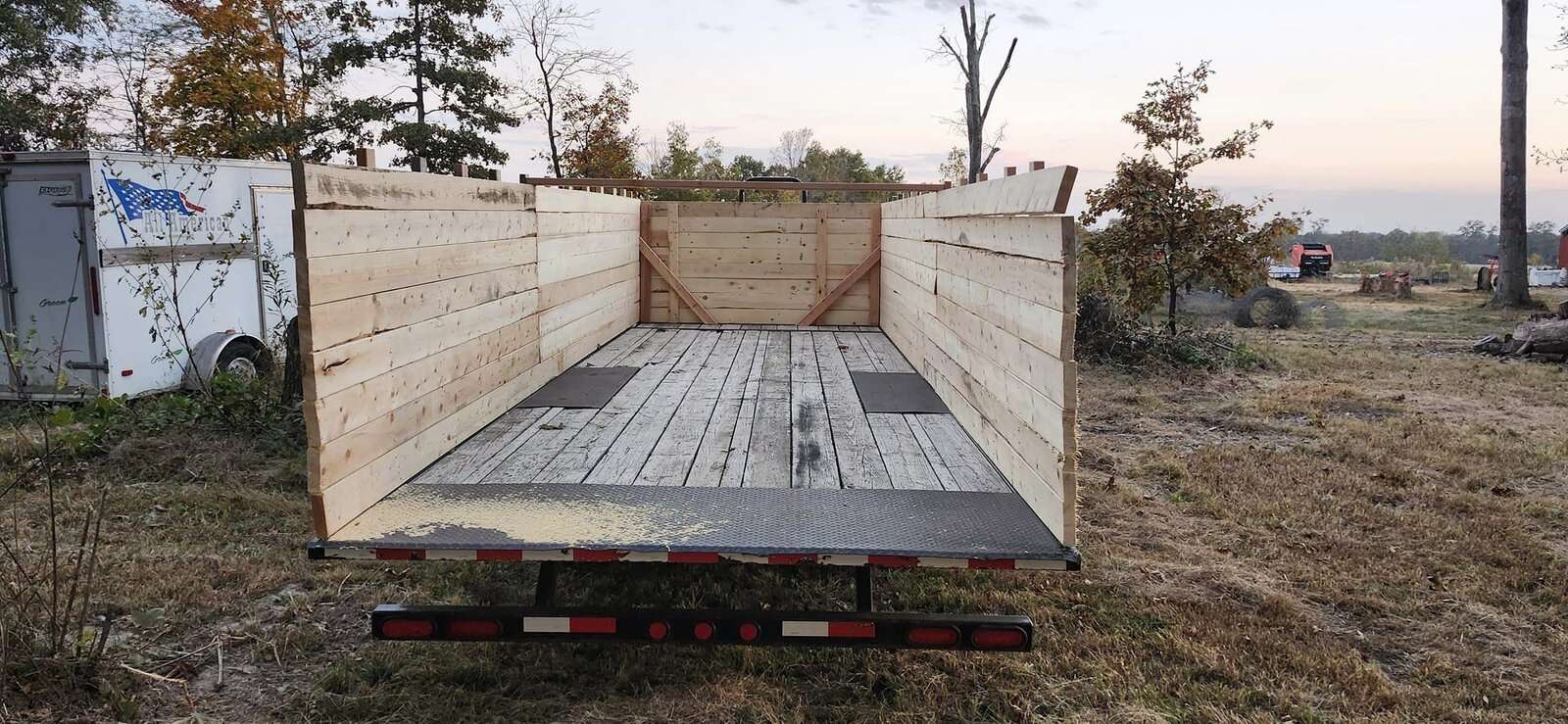

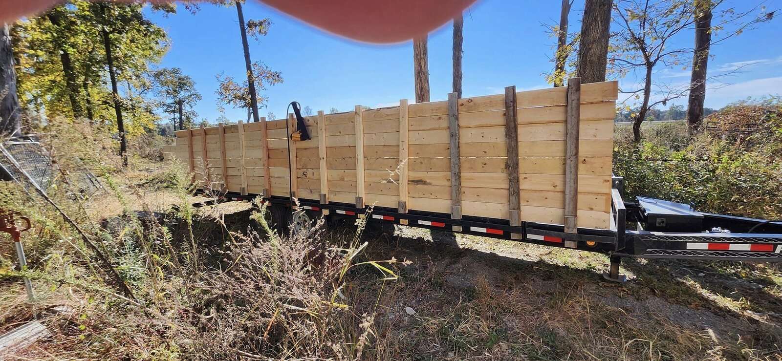

    Got it mostly finished today :)
