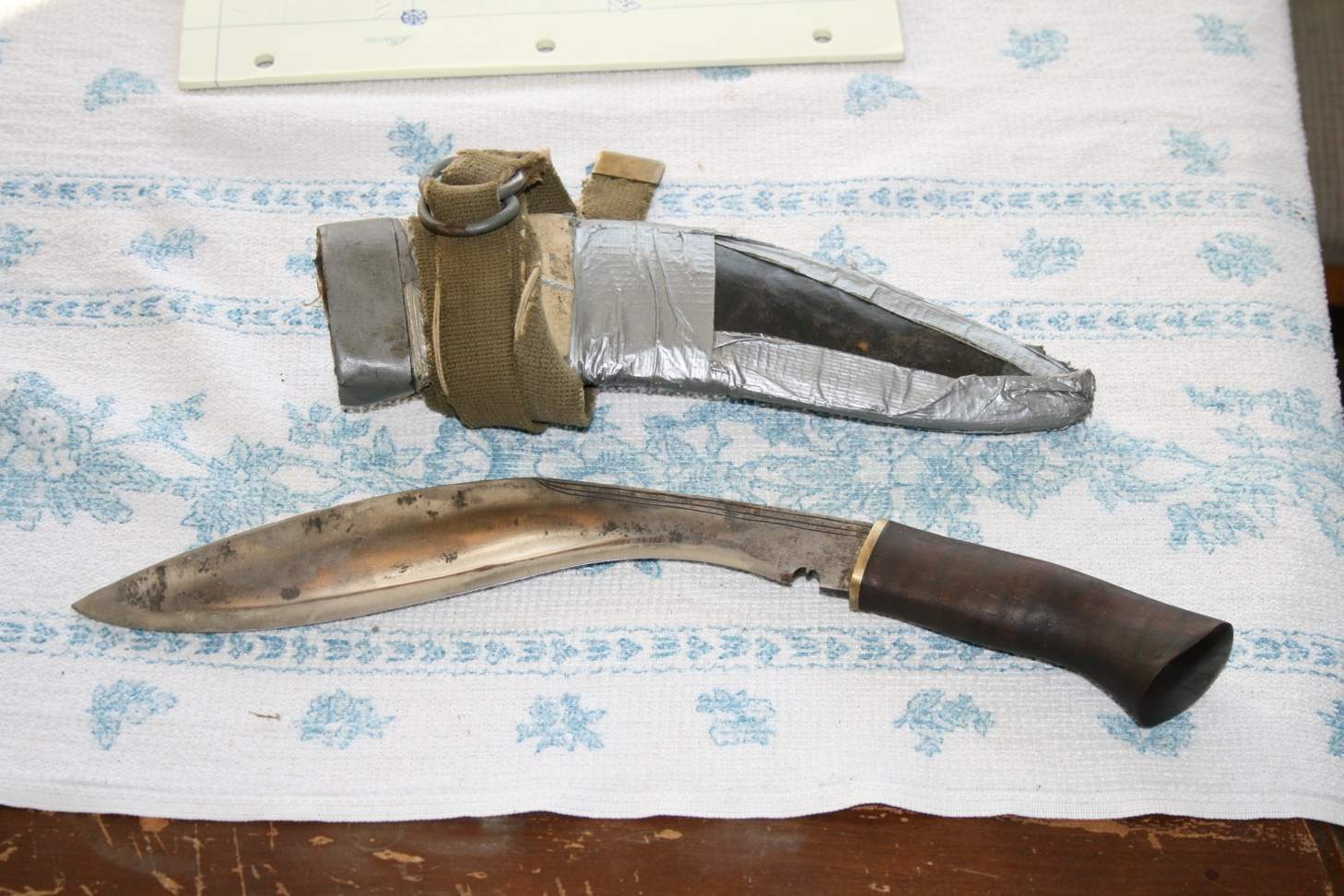

    I bought this khukris in the fall of 1980 about two weeks on the trail in Nepal. I knew enough Nepali to get along in conversation and ran across it's previous owner using it on a tree he had felled. We chit chatted a bit as he showed me how he used it, then I offered him a deal he couldn't refuse, though only a few USD. It was misplaced at my Dad's house some 30+ years ago and I ran across it yesterday going through his estate. To give you an idea of the size it is 12" from tip to the handle, and a bit over 16" from tip to the back of the handle. It's still razor sharp.
    These knives are amazing and if I could only choose one survival tool this is the one. The balance of these blades is incredible and the knife feels very light in your hand. In the mid 1980's we went to my sister's house in Washington State and took down over 20 big trees there in one day (a large family operation!). When it came time to start limbing I grabbed this instead of a chainsaw and I easily kept up with everybody else.
    The knife is not of the mass produced variety and likely made by a blacksmith in one of the larger villages. The metal shows evidence of having been folded and when you look at the very edge you can see grain of the steel as it follows the edge.
    As you can see the blade is still in very good shape though a bit discolored from being in the sheath for so long. I'd like to know what our resident knife smiths would suggest for cleaning it up and preserving the metal as well as possible.
    The second thing is the grip. The original grip was a very nicely carved piece of hardwood, but was sized for the smaller hands of the Nepali. The tang is a relatively small trapezoid that went up the center. It eventually came off (the fellow who sold it to me mentioned that you had to periodically reglue the handles) and I cut a thin piece of wood to fit and made the handle it has today. It's wrapped in a cushioned handlebar tape. I'm wondering if the tang could be enlarged into a full size tang so I could place a more conventional (and comfortable) grip on it.

  11. snake6264
    Wash it with some good hot soapy water and give it a good oiling
    you could always replace the handle if you wanted to but really a nice knife it will Kiiiiillll

  12. Bishop
    Bishop Monkey+++
    Make you up some burlap g10 for your handle it will make that blade pop out
    3M-TA3 likes this.

  14. Bishop
    Bishop Monkey+++
    The Bond is the way I make mine I like the tan burlap to me it just jumps out at you

  15. Bishop
    Bishop Monkey+++
    You can also take just string and two parts epoxy mix it up cover the just string with the epoxy and wrap the handle and let dry then sand to your liking
  16. 3M-TA3
    This is really intriguing since I could mold the burlap G10 around the tang for a perfect fit that is also epoxied in place. These knives have a partial tang that tapers to fit the classic grip. I could also make some small modifications to the tang to provide a mechanical lock as well.
    Witch Doctor 01 and chelloveck like this.
  17. Witch Doctor 01
    Consider using some pumice stone or jewelers rouge to clean up the blade....
  18. ghrit
    NO! NO! That sort of character deserves preservation, not elimination. Even if a mantle showpiece, never to cut again, the history deserves preservation. This is NOT a civil war statue.
  19. BTPost
    A Lille Acetone and MEK wiLl clean up the blade just fine...
