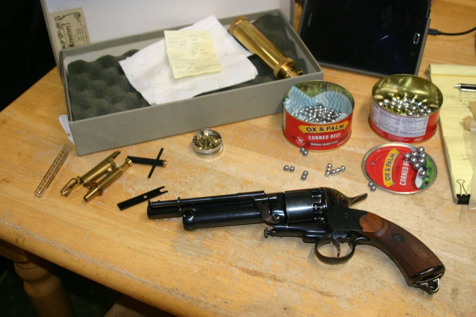

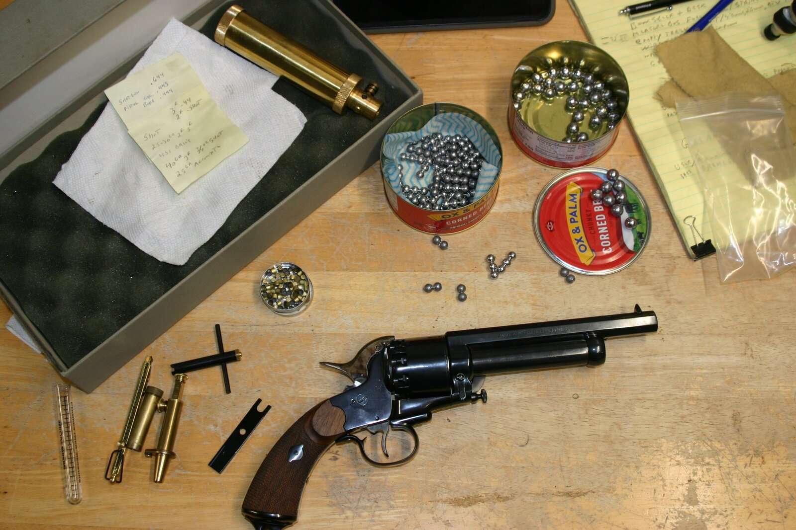

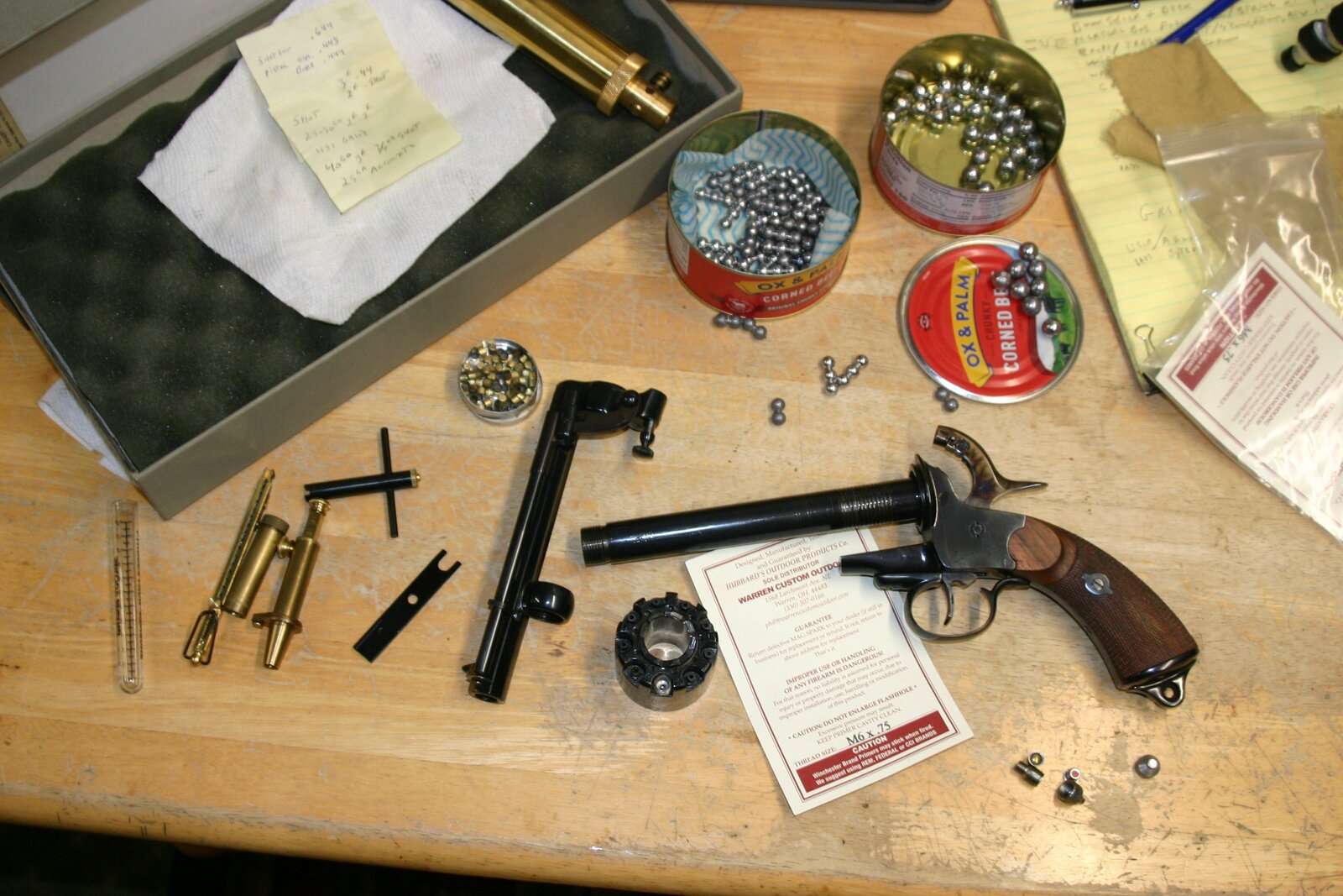

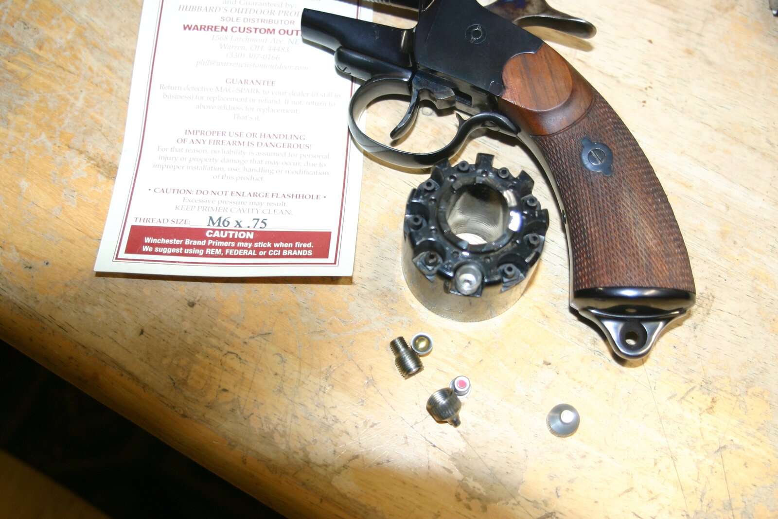

    i looked over my guns last year and was horified i had nothing in black powder. to solve that problem i went and got the coolest one i could find. of course after i got it i discovered percussion caps were made of unobtainium. shit. i found a 209 primer adapter,,, but it will take some,,,,, fitting. not just to install but even if i did the fire pin sits close to the frame and could chain fire. so not ready for 209 primers,,, yet. i did beg and scrounge about 80 caps. i think after the small tub of crisco i have all the stuff to fire it. i cast some 44 balls, but. they are not round and will free drop into the cyl if you turn them the right way. paper patch? i dont know shit about b/p. id love to find a conical mold for it.
    i saw a double end wad cutter i like that also may work. the buckshot came out ok.
    any b/p shooters on here? with 44 pistol experiance. this is gonna be fun. IMG_5878.JPG IMG_5879.JPG IMG_5880.JPG IMG_5881.JPG

    First thing I would do is find a properly sized mold,, you want it to cast TIGHT, so that when you go to load a ball or bullet, you shave or Swedge a ring of lead off as you start it in the Cylinder.
    Second, Find a pistol specific powder measure ( Looks like you might already have that one,) it's the nozzle on your blass powder flask. that has the snout set to a typical pistol charge weight, usually around 40 gr. or there abouts, you can check and tune with your little Traditions measure you have there, easy peasy!
    Finding proper caps, and or nipples so you can use all the different types of ignition, and NOT the #209 shot shell primers. Usually #9 or #11 caps is what you want.
    Next, to paper patch or not, that is the question! Here's the real truth on this, if you are using a proper sized mold, patching shouldn't be needed ( Unless your pre rolling paper cartridges, and I hope you get deep enough into it to find this a need) I can help here when/if you get there. The long and short of this, Paper patching isn't going to prevent chain fire, only a proper fitting cast projectile that shaves a little lead off the projectile when loading will prevent a chain fire. NOPE, grease will not prevent this, it may help, but shouldn't be relied upon to prevent it!

    Yeah, depending on the cylinder you may need .451 to .455 ball...it should shave some off, but you shouldn't need to really get on it to load it.
    Zimmy and Ura-Ki like this.
  6. kissmybrass
    kissmybrass brass monkey
    i think what im missing is use soft lead and go over size. thanks folks who actuallly shoot helps.
