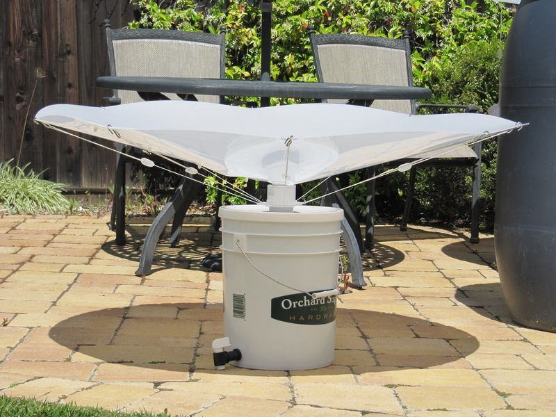

    I'm not sure what your rainfall is in your local, but here I could collect enough for the entire neighborhood in one season just from s simple catchment system. Like this one...
