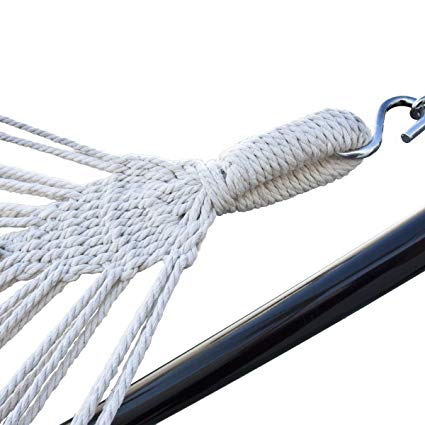

    I have made my hammocks from soft cotton canvas. Hand sewn the ends and then sew in hand made grommets and lace up the individual ropes into a "Hammock Knot".
    Concerns for the tree leads me to suggest making your own straps.
    Cotton rope is cheap and will not hurt most barks.
    Cotton rope of the 1/4 inch size will stretch but if it is a 3 braid and tied correctly then it will last the night and is easy to secure with a square knot. The correct way is to have a hand made loop in the middle of the tree strap. Have the tree strap long enough to wrap around the tree and meet the other end at the opposite rope on the back side of the tree. This prevents downward slippage and allows a solid square not on the back side of the tree.
    The center loop in the tree strap allows a center pull point that is stable and will not slip.
    Takes longer to to write about it than it takes to actually make it.
    Any 3rd class Deck Ape/Bosuns Mate can do it.
    Or your average Monkey
