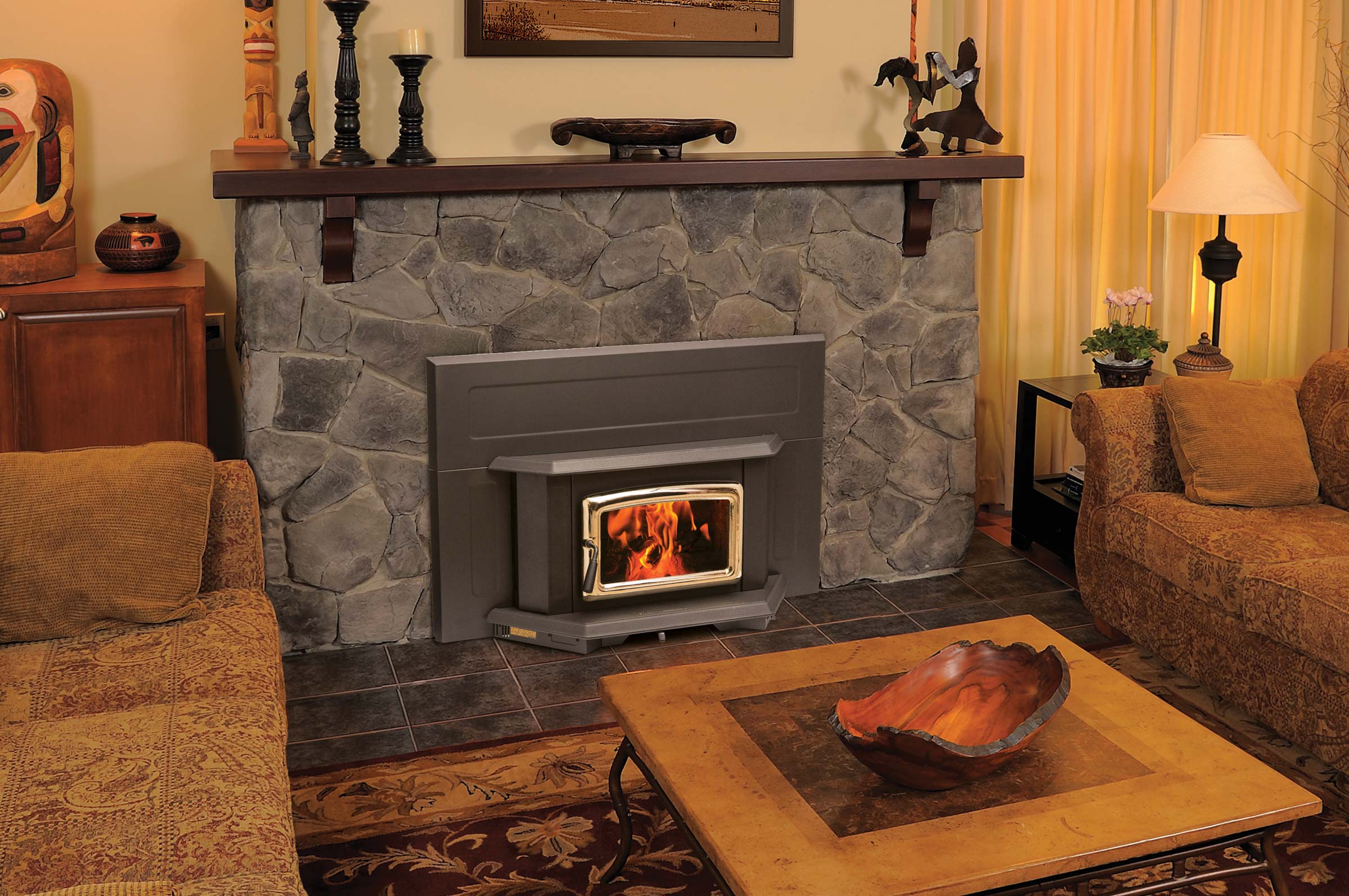

    Insert stoves generally sit ALL the way back in the fireplace opening. The problem with that is they are mostly dependent on a fan to draw in room air to give you heat...not much radiant heat like you get off a free standing stove out in the room. Fortunately, when I gave up my open fireplace, I happened to run across Regency stoves....and I bought their 'hearth heater' model. It does have the fan of course, but it also sticks out far enough in the room so you get a lot of radiant heat. You can even use the top to cook on.
    H2100 Wood Insert - Wood Fireplace Inserts - Regency Fireplace Products
    Stove is great....cut our wood use by 1/2 -2/3rds. Downside is you need a fairly deep hearth for it, and the firebox is too small for me. I didn't understand this new gassifer technology when I bought it in terms of stove size . The old rule of thumb was "don't buy too big"....because in order to burn efficiently and NOT produce a ton of creosote, you need to keep enough air going in the stove to keep a hot fire, meaning a big stove in a small area would over heat the area. SO I went with the smaller of the two they made at the time (now they only make the one model).....it only has a 1.6cuft firebox, and it's hard to cram enough wood in it to get an all night burn. With the gassifier stoves, buy the BIGGEST dadgum one that will fit your space. I'm thinking about upgrading to their I3100 insert because it has nearly twice the firebox size. It doesn't stick out as far as my current model, but supposed to still be able to set a cooking pot on it's top, so I think that should be enough.
