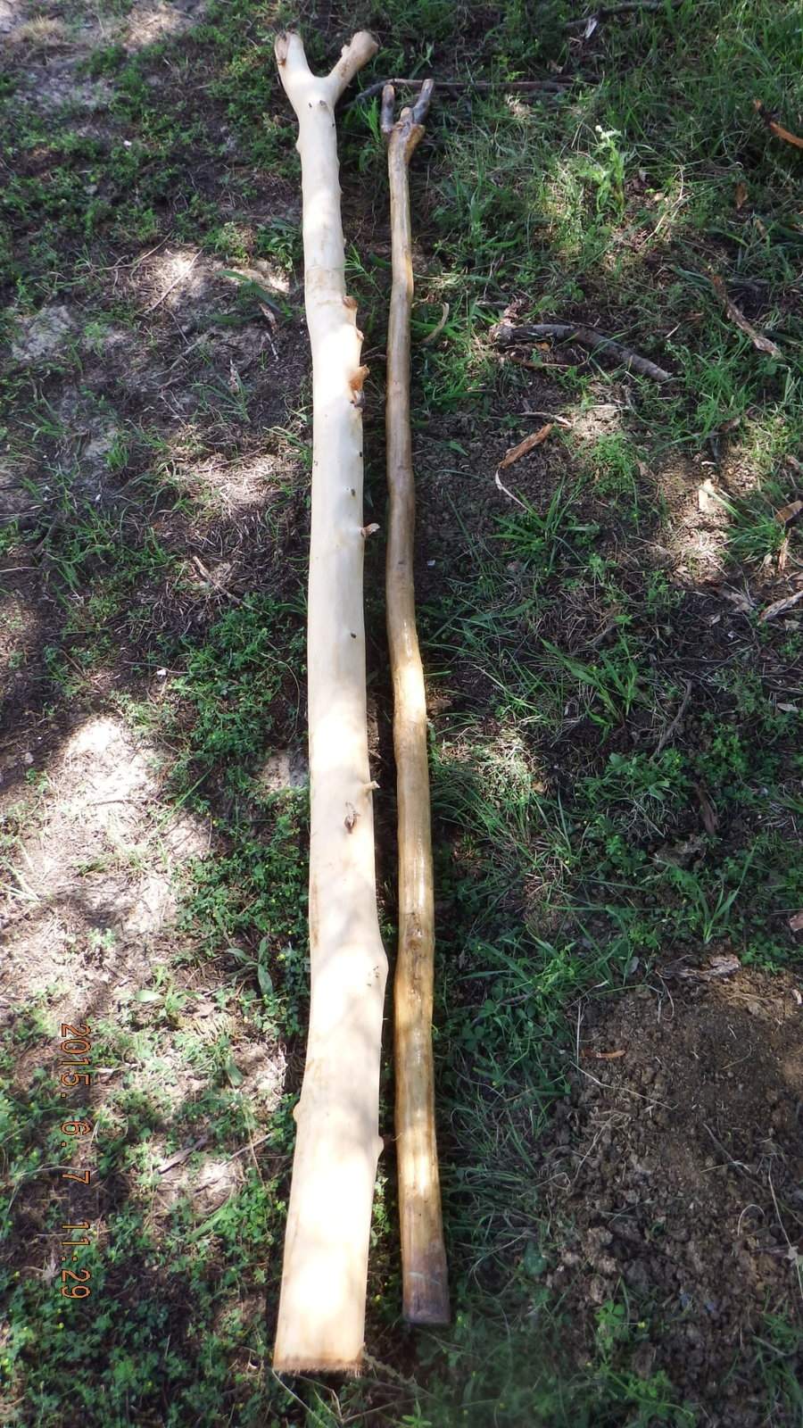

    As seen here the Cow Stick now weighs 17lbs, so we lost 5 lbs in the debarking. I figure we will loose another 2lbs when it dries and I trim it.
    Now you can see why I did not use a Draw Knife in the first or second pass, had I made that mistake then I would have cut chunks from the wood and hacked up every knot I came to. But now it is just a matter of the drying time and smoothing the Staff after that.
    Save the bark for repairs, cordage or other building projects.
    Please avert your eyes if naked trees bother your sensibilities.
    There you have it, a Naked Tree and its little brother!
    Now to let dry.

    The Cow Stick is now down to 11 lbs and time to check the natural balance point and the drying process.
    Maybe even check for fit of the Pointy End too.
    Here the Cow Stick sets on its chosen balance point. The Balance Point also includes the natural curve of Cow Stick and how the forks settle in. This is most important because you need to have the natural balance and the location of the fork in the position of function. Otherwise you will reposition the Cow Stick each time you need to use it. This can cause fatigue and miss strikes when you need the forks or the Pointy End the most. The knots have been rasped to help the internal drying of the Cow Stick and then on to the next part.
