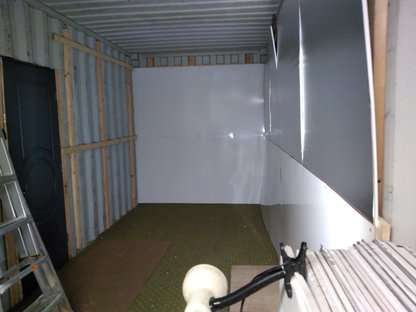

  10. kissmybrass
    kissmybrass brass monkey Site Supporter+++
    so i live in a bus, was not eniugh room so i got a couple connexs and have living space in them. well one. i just got them set oct.
    on framing inside. i put 2x4 in the grooves and screwed them in tgen did firing strips to mount 1/2 foam and 1/8 panels. the criling is 1" foam panels. to keep it from dripping on the ceiling i put 10 sheets of 1\2 foam board outsise and covered it with a tarp. worked great.

  11. kissmybrass
    IMG_20241109_184646.
    when i did this i should have done 2x4 on the outside too. spray foam is king.i live in alaska and spray foamed my v nose trailer and van. best way to stop condensahion i have found.

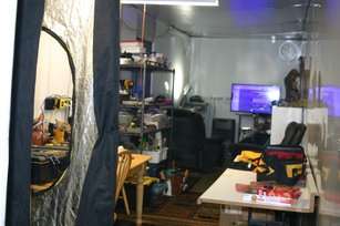

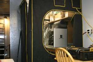

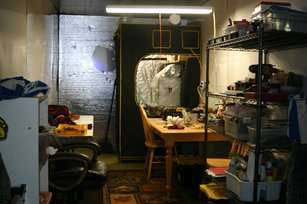

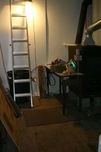

  13. kissmybrass
    man cave. tv/computer area then gun shop stuff. grow tent for,,,, 3dp and powder coat. control smell and humidity. wood stove in back. i hauled guard rail to cover them for a sod roof. still moving in.
