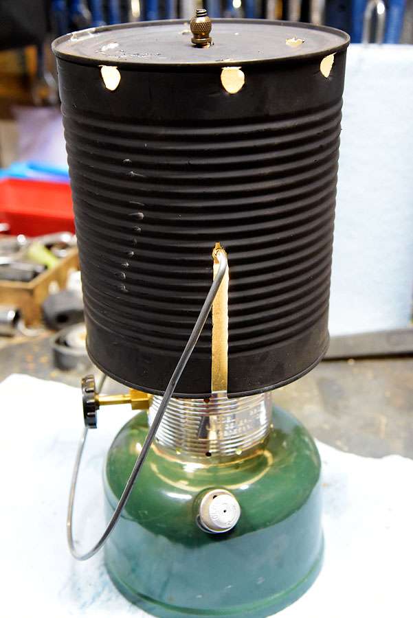

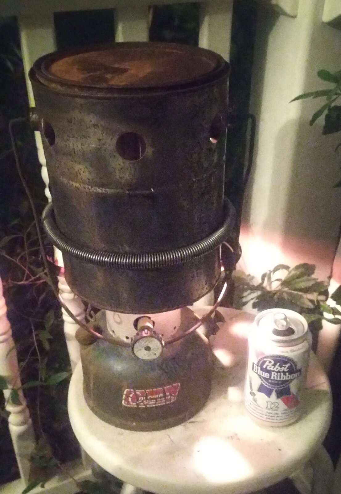

    It's not as goofy an idea as you might think. Two of up on opposite ends of the country came up with different designs, but the accomplish the same goal. Taking the chill off under a table while drinking beer. Timm's pub heater is much simpler and requires only a #10 coffee can, a drill and a tin snips.
    51806511843_f069779190_o (2).
    Just remove the vent and globe and drop on the can.

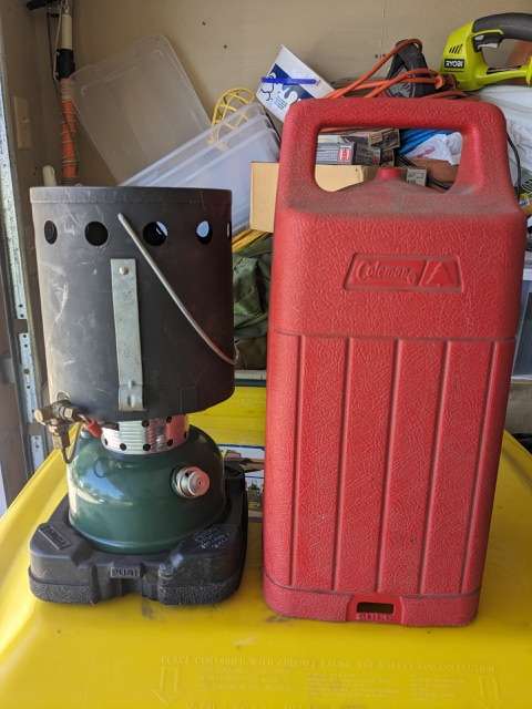

    Mine was built to mimic the heat drum on Coleman single burner stoves. It required welding, punching metal, removing the lantern bail and some additional parts.
    PXL_20230904_165912606_Original.
    IMG_20231031_004911.

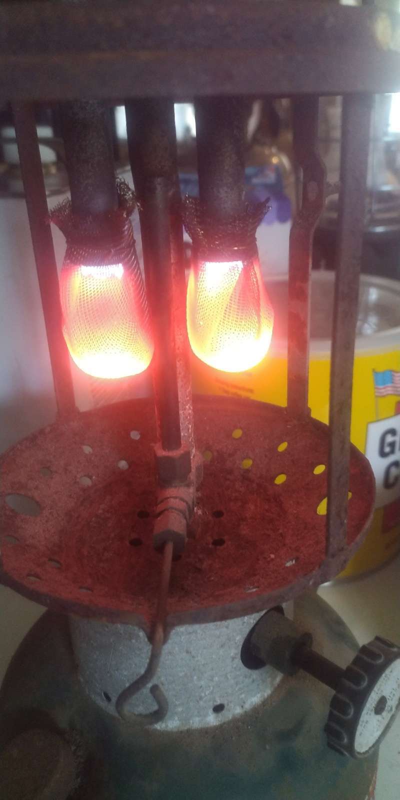

    The magic in mine is on the indestructible stainless steel mesh "mantles." They made from a dollar store grease splash shield that goes over a frying pan. I just cut off a piece, wrapped it around a broom handle and clamped it there with a hose clamp while I smashed it into shape. Once formed it was easily mounted on the lantern burner with stainless steel safety wire.
    They get plenty hot enough to heat the generator, burn clean and light up just like a regular mantle.
    IMG_20230307_095222.
    I'm sure there are better ways, more refinements and some tricks I've missed, but it never really gets that cold here at the beach, so it's been enough for me.
