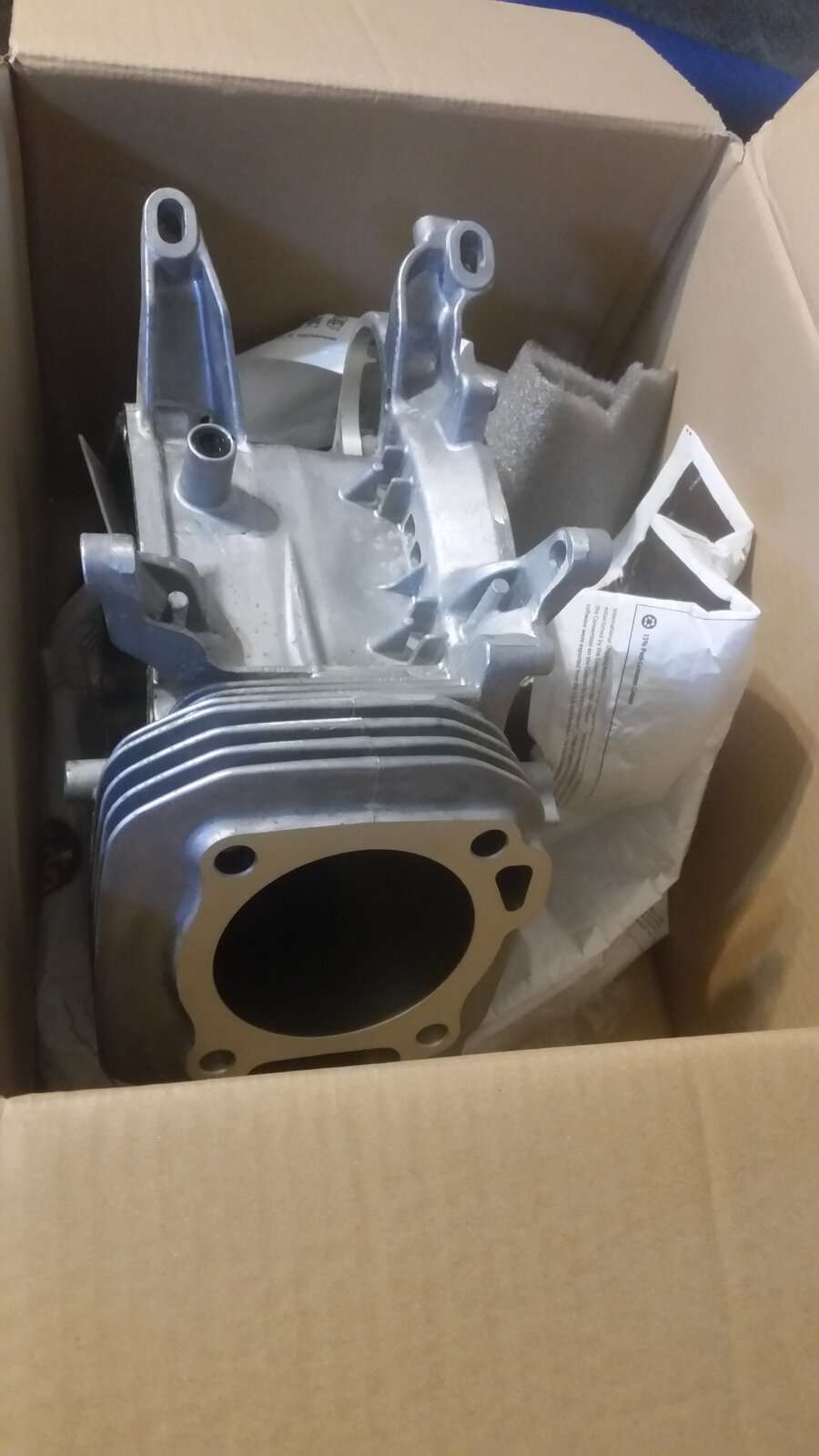

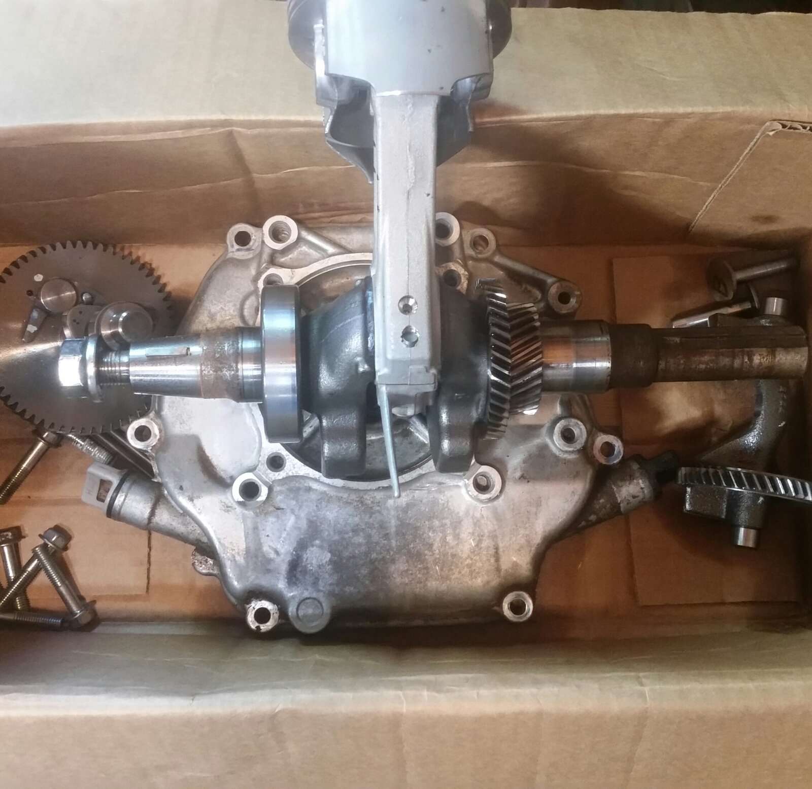

    I have an old Honda gx390 that ran for a while with effectively no air filter, so it burns oil. Well I'm rebuilding it.
    The bore has some taper and oil rings were worn down to nothing. I guess dirt likes to get caught in the oil rings and wear them out. It burned oil like crazy. Because of no air filter and sum dumb ass put the biggest carburetor jet they could find in it so the oil and dirt were getting washed down the cylinder by ridiculous amounts gasoline. That results in an engine you fill up with oil run it and the low oil shutdown kicks the engine off after 45 minutes to an hour.
    Rebuilding this the be about a 48 state legal de-CARB'ed engine. With a new std bore block, std piston, new rod, new tappets, 0.01 over bore rings I'm using as file fit rings, ultra thin head gasket that will bump compression about a half number, I'll test timing advance, retard and put a retro style adjustable carb on it.
    The higher compression, possibly advanced timing, and adjustable carburetor will give more power, use less fuel and make a tiny bit more NOx than the 50 state legal version.

    Got the new engine mostly put back together.
    The old worn out engine had 72psi of compression cold and 72psi warm.
  11. oil pan 4
    Also I can't reach a third of them, because they are clumped together.
    I used a "F188" Honda knockoff piston. Now my cold never fired compression is about 120psi.
    Everything I can find on the internet says compression on a stock engine is about 100 to 105 psi close to sea level.
    I'm at 4,000ft with about 12% less air.
    It runs great it started on the first pull.
    I put a carb with adjustable air bleed, it came with a big old main jet, unmarked of course, definitely least a 1mm or #100, probably a 104, ran rich, smoked on throttle up.
    First test I did was swap in a #69, it didn't want to stay running and I expected that. Next step up because it wouldn't run I skipped over all of my 70s jets and went with a #86, it would run, but didn't want to throttle up quicly still too lean and I think I got some engine knock because of it running lean and having such high compression.
    I thought I had a 90 and 92 but didn't find them, so I stuck in a 95 and ordered another 100, 97, 95, 92 and 90 set.

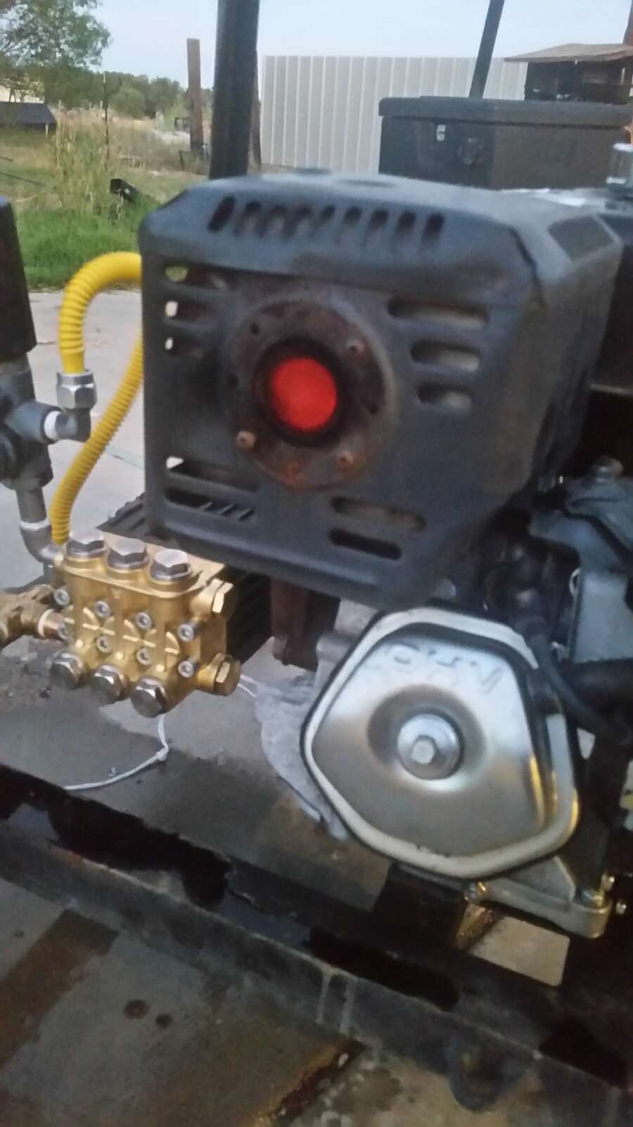

    20230703_202901.
    Yes that's a gas line I'm using as a return.

    Ran up the gx390 powered 4gpm pressure washer to clean off the solar panels.
    It was a nice day in the low 80s, perfect day for cleaning solar panels. I bought an oil dipstick temperature gauge.
    I knew the gx390 runs hot running 4,000rpm and wide open throttle for an hour at a time, well now I know how hot. The temperature of the oil peaked at 260F. On a 100F day that could easily be 280F. Yeah dats hot. Too hot.
    I should probably investigate ways to cool down the oil a bit and filter it too, might as well just for the hell of it.

  20. oil pan 4
    The under side of the engine is irregular shaped and has a gap in the fan shroud to allow for some cooling air to it.
    I probably have a liquid to liquid heat exchanger around some where and could run the oil as cool as I want it, assuming I have a way to circulate the oil.
