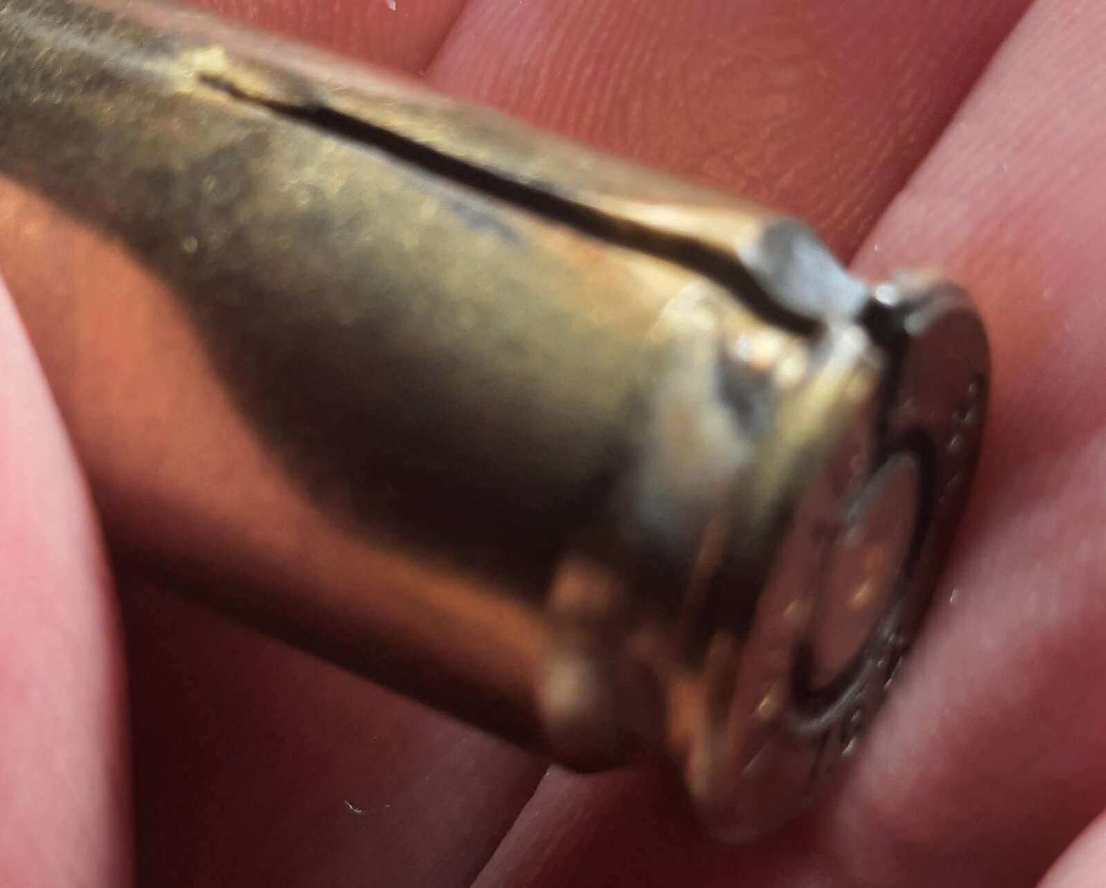

    Hi guys. This is my short review of Aguila ammo made in Mexico. I posted this video a few hours ago and have gotten dozens of people telling me they have had the same problems. It's cheap but you get what you pay for. In my case it blew up in my face and destroyed my magazine.

    I'd like to see a crystal clear close up of that split case so we could see if there was a case wall variance. Pausing the video i just couldn't see the wall, base or case head to look at disruption or failure mode.
    AgentPickle likes this.

  14. AgentPickle
    AgentPickle Monkey
    I will take an close up and post it here.
    duane, VisuTrac, Brokor and 1 other person like this.

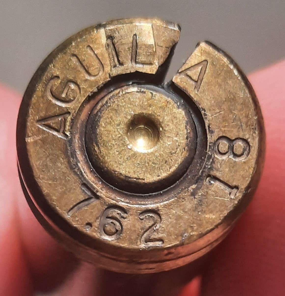

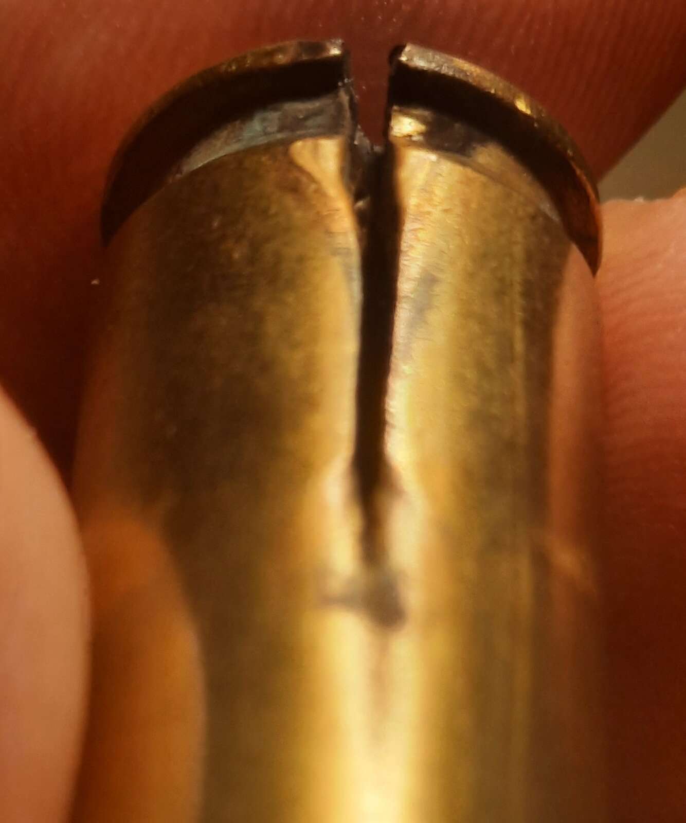

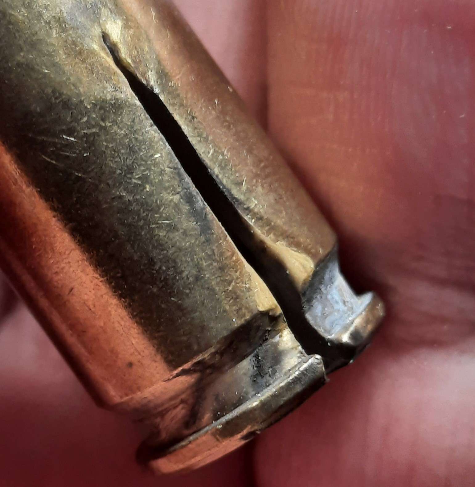

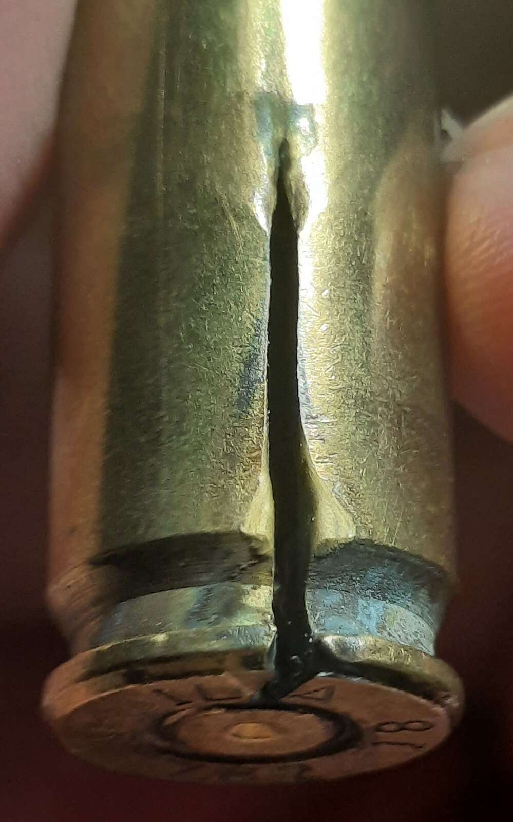

    OK A few people requested some close ups of the case so here ya go.

  19. Seawolf1090
    Could the rifle have fired out of battery? Looks like the case was unsupported when fired.
  20. VisuTrac
    I'm thinking with how smooth that flame cut through the case head is, your bolt and receiver now has been flame sprayed brass everywhere in there.
    Case diameter still with in spec or is bulging near the case head?
    Either way. Holy Wah that was a spicy trigger pull.
