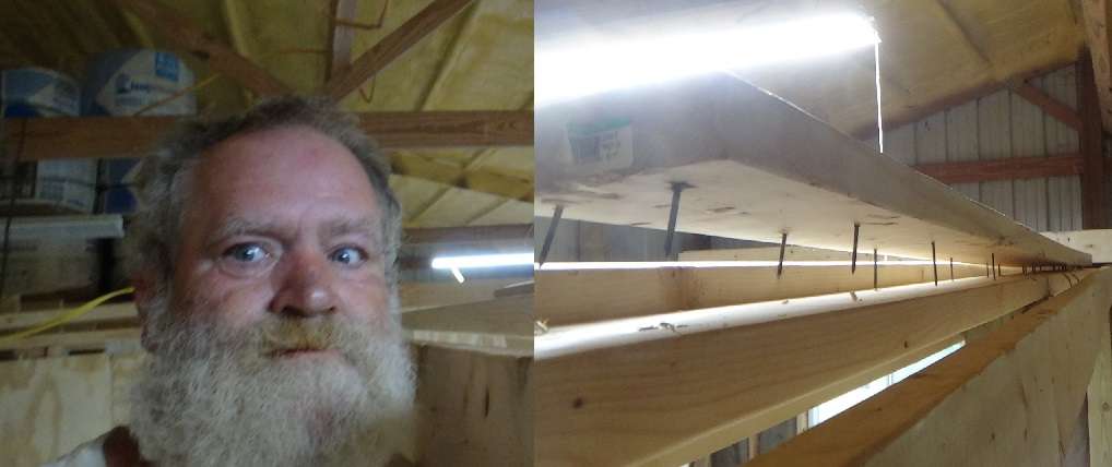

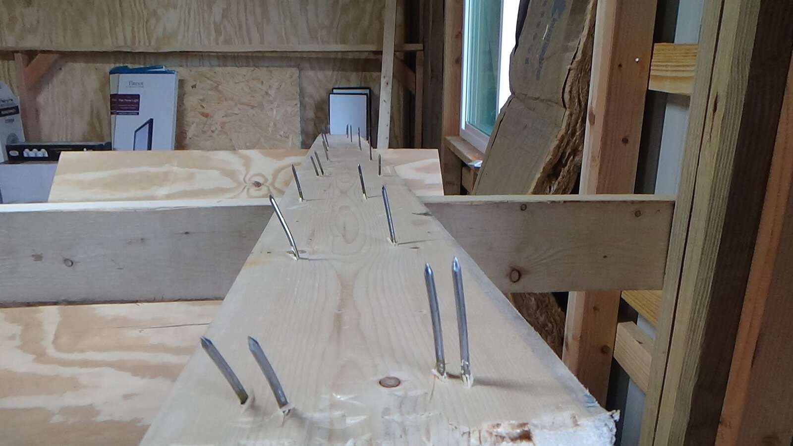

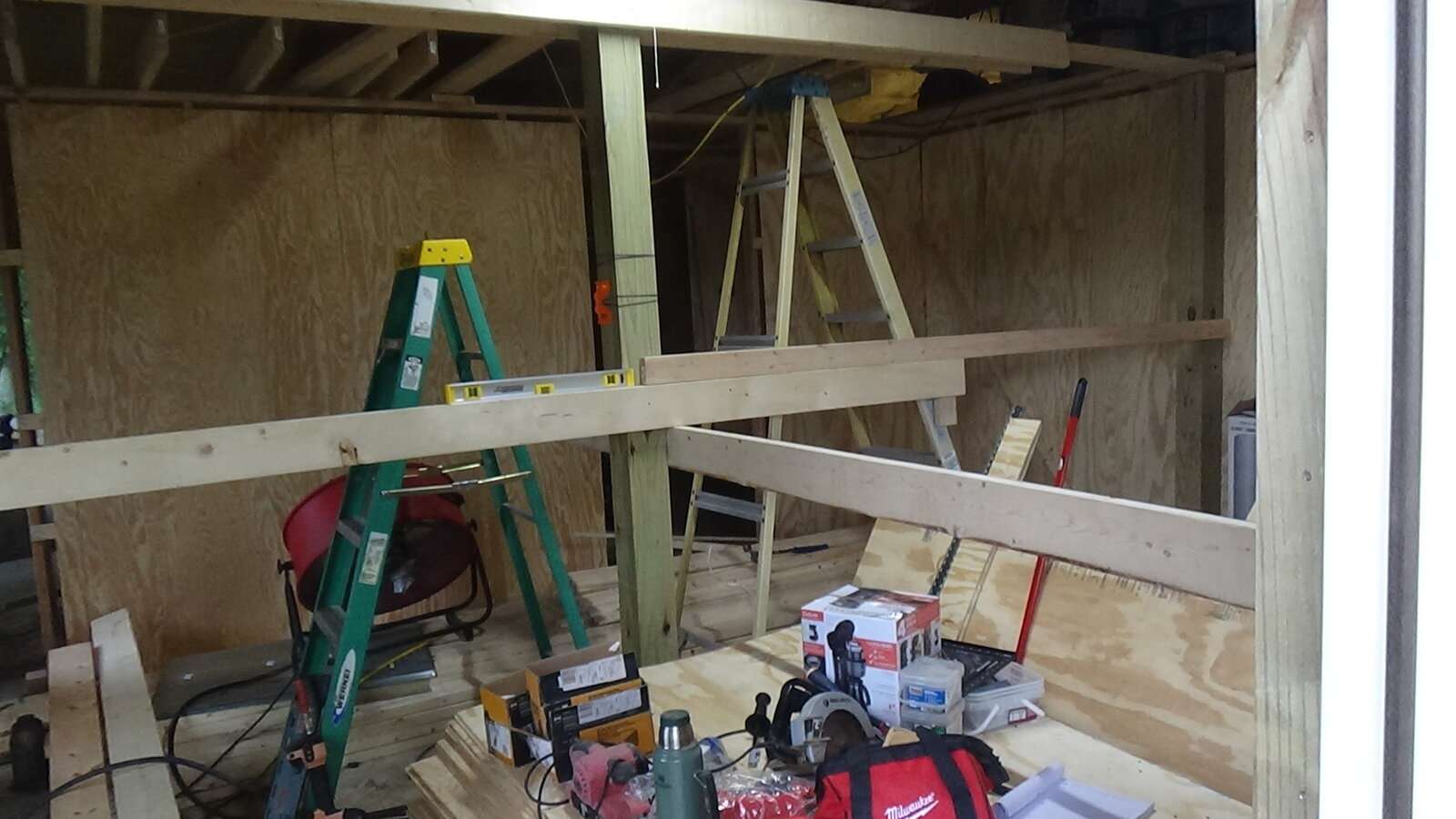

    The two biggest and hardest jobs that were left is spanning the Master Bedroom with the rafters and getting the post and beam that they have to rest on up. I did the post and beam today. I used temp treated 6x6 post and a temp beam built out of 2x6s and right off the bat made a error.
    This is pretty much the face I make when it dawns on me I did something REALLY DUMB and have to pry it apart after putting 600 nails in it so it will be there for all time..... At least I didn't use liquid nails :) A 1x6 was supposed to go in the groove NOT a 2x6
    That look I make.
    On the bright side I got a good board that I hope does not fall off a trailer on the trail the trespassers like to use!
    No getting around the post being heavy and the 2x6x16s heavy and clumsy to maneuver around. I used the simple trick of crossing boards on the post to hold them plumb while I got the beam built and the first two rafters across. The challenge here is I am doing all of the work by myself and the Master bedroom being 16'x20' is a real challenge to span with the rafters and to get beam square and straight. The top gap on the walls is intended a 1x6 is going to cover the gap behind the plywood and is needed for how I am going to do the ceiling. Why Skin the walls with plywood on laterals. BECAUSE IT IS EASY and I hate drywall :) I really do hate drywall but there is logic behind my wall madness :) I have to wait a year for the Red Oak 1x8s to cure, dry down and shrink. They are real wet and will take every bit of a year stacked in the shed with fans on them before they are ready to run through the planer/sander and across the table saw to angle the edges like / so they fit together nice and snug on the wall. So the plywood walls are what I have until then. The walls also need backing and I got this 1/4" plywood for $3 per sheet, no idea why but home depot had two full stacks of it marked down 2/3s off and I snagged both bundles of it. I am using R24 Insulation bats inside of every interior wall and compartmentalizing them for heating and cooling. The Master Bedroom and my corner office are going to share a 22btu Mini Split with 2 heads. The Living room and Kitchen are getting a 30k BTU with 3 heads. The Laundry room and bathroom get nothing except a space heater and whatever cool comes in from the living room. The laterals under the plywood..... You can't screw 1x8s to studs :) Unless you put them crossways but I am putting them up and down so laterals are the right prescription. So R24 Bats, skinned on wither side with 1/4" plywood and a 1" air gap on either side between laterals and insulation and finally 2 inches of red oak on either side. Each room will be very well insulated and very little if any sound will make it through the walls. I am going to skin the ceiling with plywood as well but don't need laterals up the as the 1x8s will be going across the rafters. Filling between the rafter with R30 Rolls and topping it with 3/4" OSB. Getting the bundle of OSB into the loft is the single biggest and hardest job of the house project....... THAT KRAP IS HEAVY and 38 sheets have to get thrown up on the rafters to make the floor.

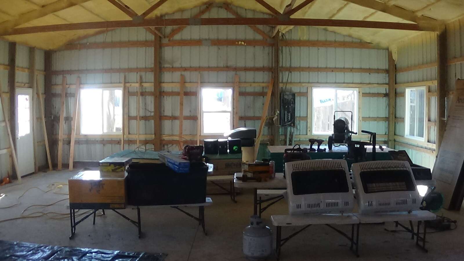

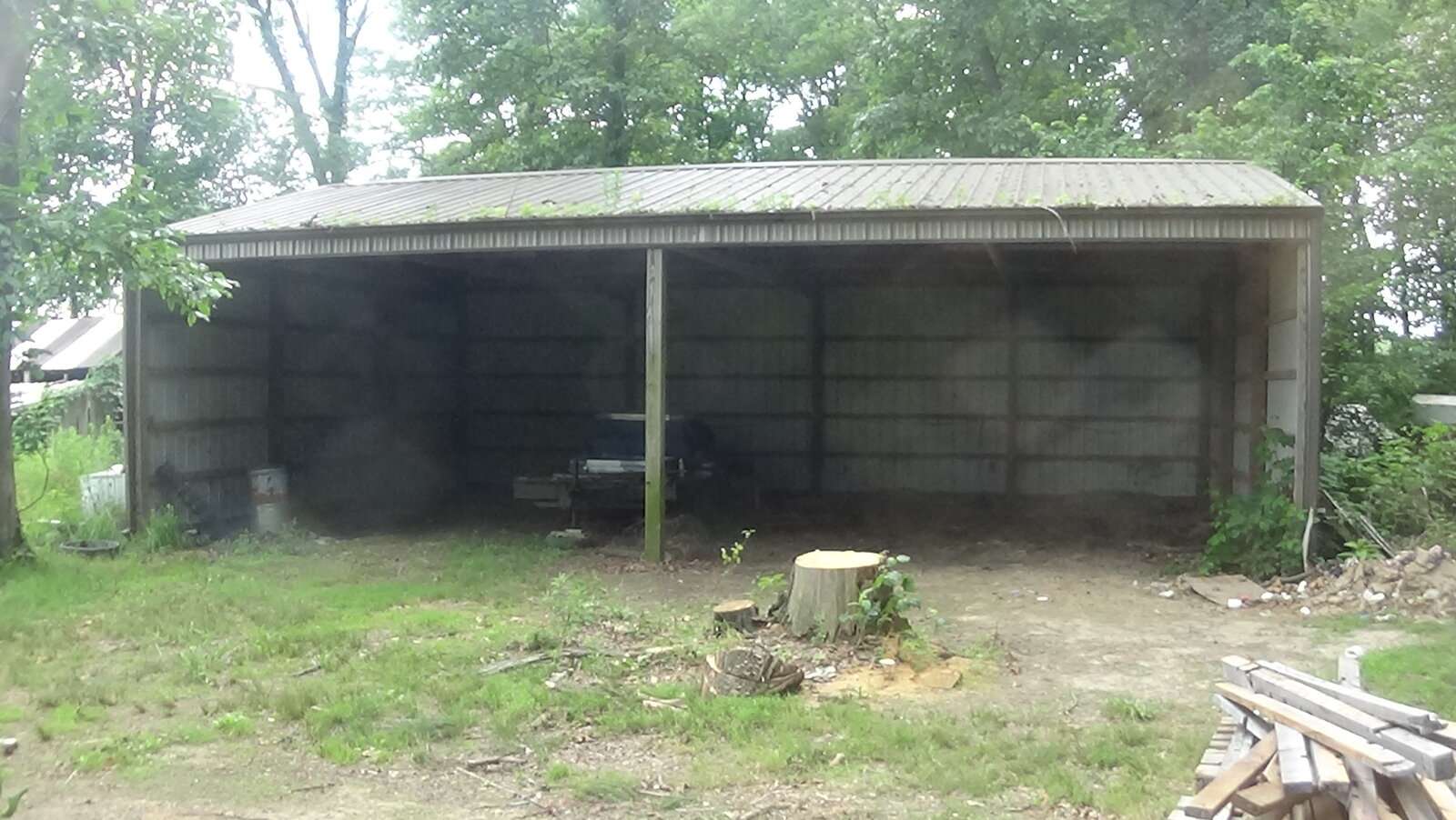

    What I started out with..... Was a Open sided hay and catch all barn I built in 2012.
    After I closed the side and put the doors and windows in and poured a 6" Concrete floor......
    To where it is now..... Its easy to forget just how much I have got done and think only of how much there is left to do. It will take me another 6 months to completely finish it except for the Red Oak and Pecan walls and ceilings, I just wont put it up green and have to deal with the shrinkage on the walls and fresh milled red oak smells like rotten ass LOL.

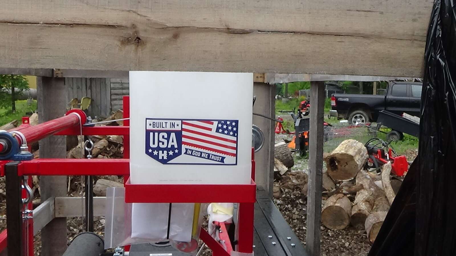

    Yep and man has Hud-Son gone cheap on the engines.

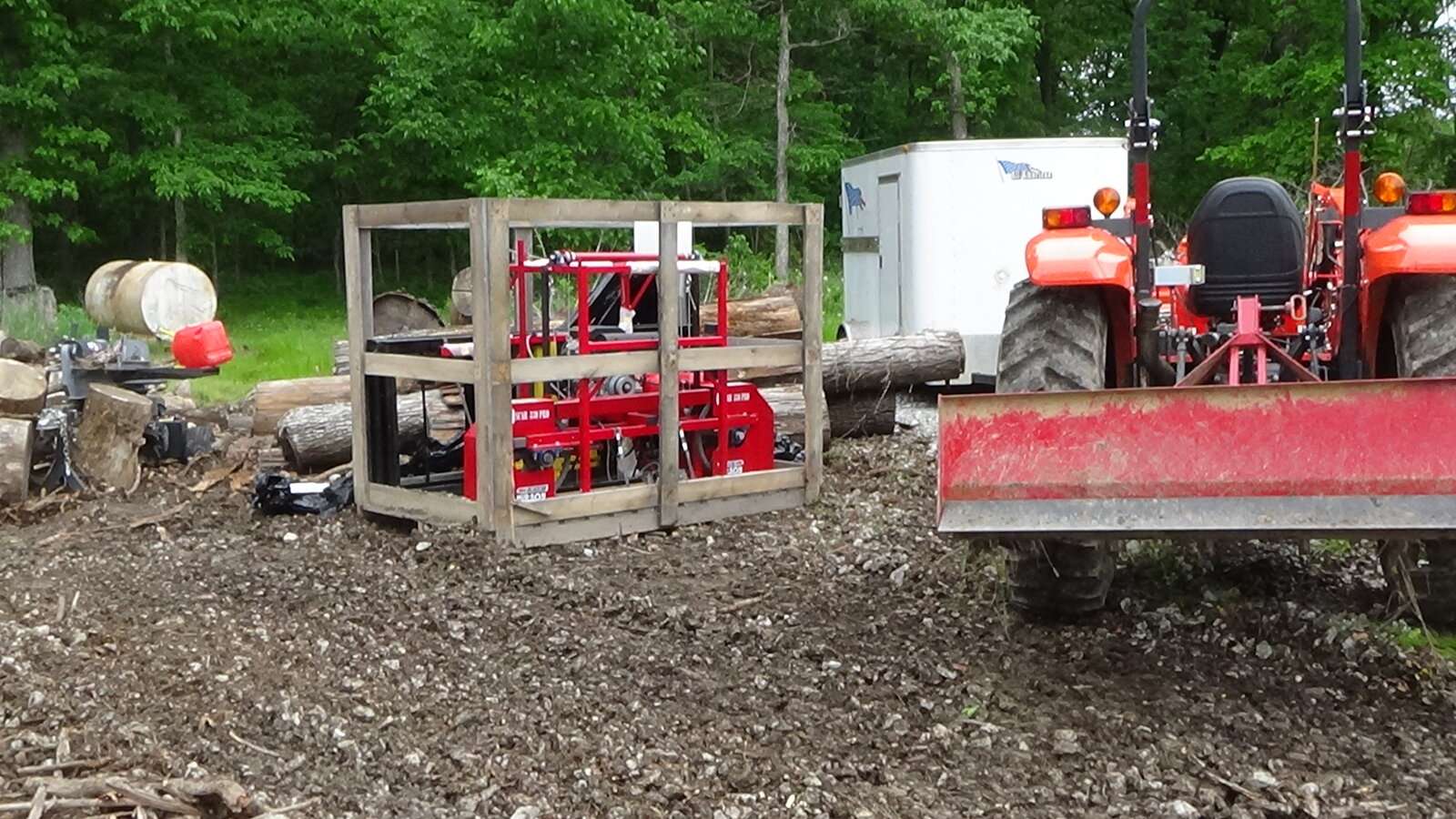

    I got it about 3 weeks back and its still sitting in the crate. I am going to pour a 48" x 28' concrete pad for it and build a curing shed right beside it with a overhang that covers the mill head. I may just get another 24x42 Carpot like what I used for the Machine shed and just leave open on all 4 sides and build lean to off of it and 2 walls on the lean to to cover the head.

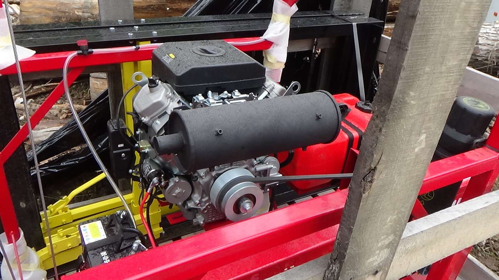

    I crawled up their back side the day it arrived and saw this piece of garbage engine on it. Total no name import engine under the Lifin brand. With a 250 hour very limited warranty. 250 hours is like 5 weeks worth of warranty when I start milling. They would be better off putting Harbor Freight Predator engines on them than this garbage. I have a pair of never used Briggs 23hp Vanguard V Twins I got for water pump replacement engines and to replace the one on the old mill when it wore out beyond repair. And a Newer Kohler Command Pro 25 all will fit the new mill. I will run the garbage until it pops or puts a rod through the block and put one of the good engines on it. Bands took as long as the mill to arrive but I finally got the two cases of silver tips from Woodmizer. ... And BANDS ARE NOT CHEAP now days.

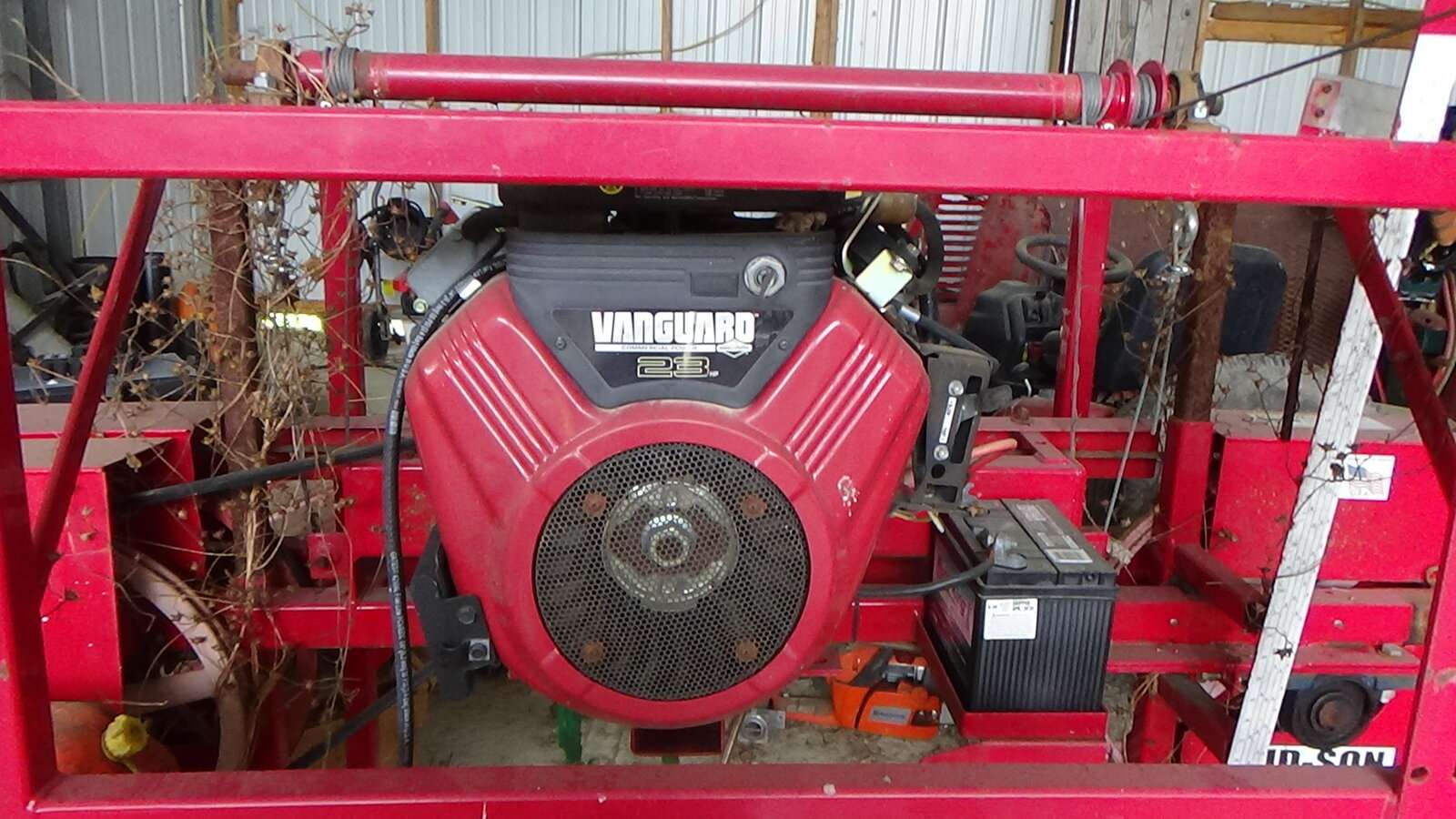

    The last pic of the old mill before it walked away...... I ran that engine for 10 years with 2 rebuilds on it and that mill and engine had at least 5000 hours on it. Apologies again for how that all worked out. It was old and needed a good bit of work like all new bearings and little stuff that I broke or wore out over the years like the rubber on the flywheels but had 3-4 more years of life that could have been put back in to it. Just my opinion but you can't beat those old 23hp Vanguard V twins for dependability.

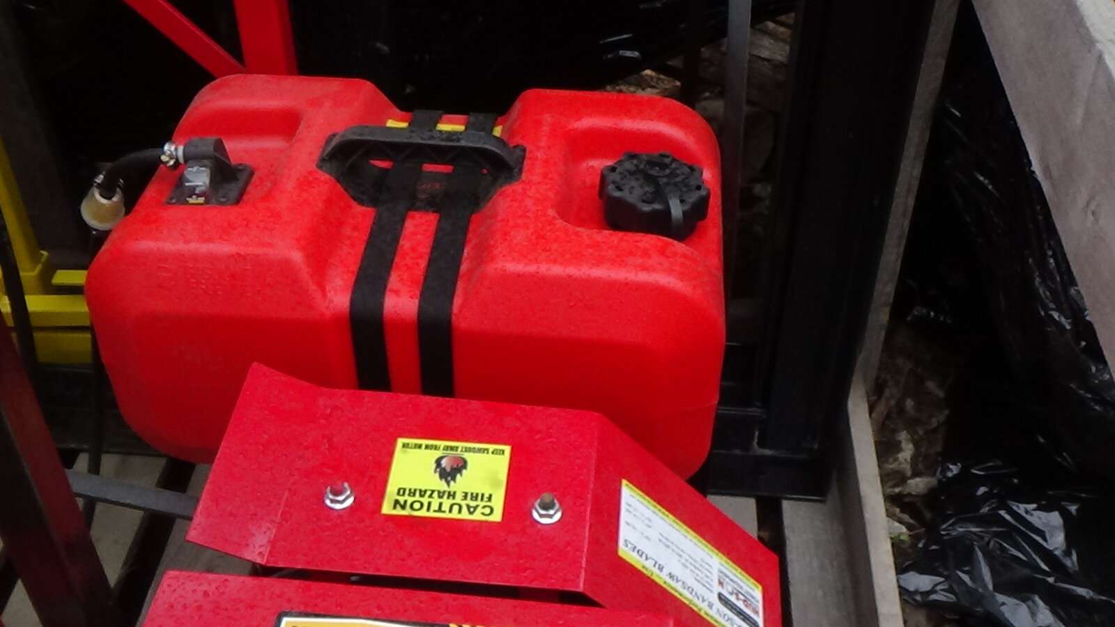

    They did make a few improvements based on our feedback back in 2010 on the machine. The Fuel tank and fuel draw system and the water lube tank. A big water tank with a kit for hooking a hose straight to it instead of having to refill it. Tank on the old one was 2.5 gallons and I had to create a hose kit for it. 2.5 gallons would not get you through 1 small log LOL
    I love the new fuel tank and fuel draw. The old one the fuel was pretty much gravity fed And thus sat high up on the mill frame. I put a cheap fuel pump in line and relocated the tank to low on the head frame on the old one. They are doing the same thing I did now days.
