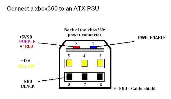

I built another last night out of an old Xbox 360 power supply(200 watt model). works the same, just looks alot better when your done with it! It's also a little easier to do!
This will give you 12v 16.5a power (using the 200w model probably less amps using the 175w model) this should be plenty to run a mobile CB and possibly a ham from the house.
Remember I ain't responsible if you fry something! Use a meter to verify output before you hook it up!
1) Remove the plastic cover from the end that connects to the Xbox.
2) Push the pins out of the plastic connecter, then cut them all off.
3) Strip and connect all the Yellow wires together.
4) Stip and connect all the black wires together.
5) Strip and connect the blue and red (some of these are purple instead of red). This turns on the 12v line and turns the light from yellow to green on the power supply.
6) Connect to the device you wish to power.
Yellow = +12v
Black = Ground
Blue = Power Enable
Red (or purple) = +5vSB
Here is a pic of the BACK of the connector...
